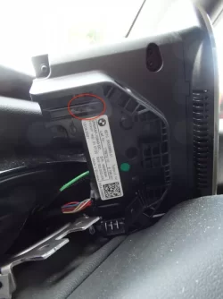

P7300731a.JPG Hi Cburg and Rexsio and others
My E-Mini is 4 years and 13,540 miles old and so out of the normal parts warranty. ( battery still covered though)
I took the advise from Cburg and removed the Instrument Pod (IP) and checked the connections and all made sure they were all fully home.
With the ignition switch on IP did come up even though it was hanging out on its lead. All looked ok except for a small area that appeared to
have what my experience as an electronics engineer suggested something was warmer that it should be inside and perhaps it had distorted the plastic. Anyone else had a look behind their IP.
did not strip it down further but the number on the label might mean something to someone
regards Bob

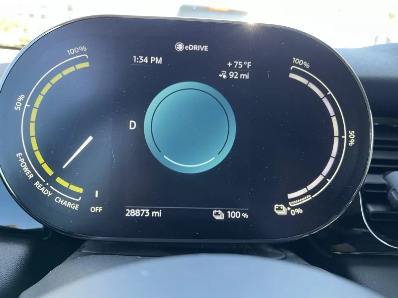

I saw this on my cluster yesterday. No speed display for the entire trip, but it resolved itself on the next start. Is this this the same thing you folks have been seeing?
