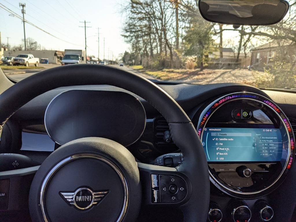

Do you have a picture of the instrument cluster being off that also shows the center display on? That should be enough proof for the dealer because the instrument cluster should never be off when the car is on.
If they still refuse, give them a bit of a hard time about it. Not having a working speedometer is a safety issue and I'm pretty sure it's illegal at least in some states. It should absolutely be covered under warranty.
The "-" for the car's efficiency data is actually a pretty big clue. According to that video I linked in my last post, the instrument cluster is fed data from the same head unit controlling the central display. The only time I've seen the dashes is when it's been reset and I haven't driven anywhere (meaning there is no data). If the central display isn't getting that data, the instrument cluster wouldn't be either so it could be an issue with the communication between the head unit and the main computer?
I also know that low 12v battery voltage can cause weird computer glitches with things randomly rebooting and resetting themselves... Shouldn't be an issue with such a new car but maybe you got a bad 12v battery?
Next time it happens, try looking through the menu on the central display and see if anything else doesn't show up. Tire pressure could be something to check.
You could also try rebooting just the central screen. I believe holding the power button (volume knob) for a couple of seconds should bring up a menu to reboot but I haven't tried it myself.

I did that on mine.
There are two torx head screws on either side of the base of the display.
It pulls foreword when these are out, and you can turn it over to see the connectors.
I was able to remove the one with multiple wires on it, but not the fiber optic and ground connector.
I went ahead and removed all of the other screws, and the circuit board was free inside.
I checked for voltage, and didn't find any on the main connector pins.
Everything seemed to be quite warm inside.
I put it back together, and it no longer resets. It seems to be permanently dead now.
I figured I didn't have anything to loose.
Good luck!
