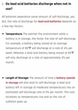

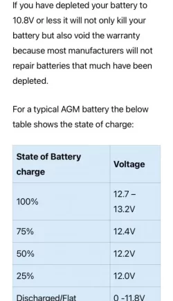

A 12V battery, left to sit for a week in a parked car, will not self-discharge more than a few percent. That will not have a statistically meaningful impact on the longevity of the battery. You don’t have to take my word on this. The information is readily available.
A battery that discharges, in one weeks time, to a level that would have a detrimental impact on longevity, is a battery that either has a load that should be removed or is already damaged.
The article that you cut and pasted mentioned how discharge rate is affected by temperature, for example 4% per week at 80 degrees. But substantially less than that at moderate temperatures. That is interesting. I knew there would be a difference but I am surprised how large a difference temperature makes on discharge rate, as 80 degrees and higher is pretty normal temperatures in many parts of the country.
