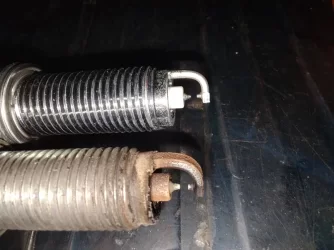

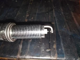

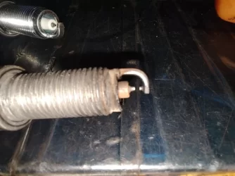

I have almost 145k miles on my Clarity PI. I decided to replace the plugs. I haven't tracked how many miles were electric and how many were ICE. I charge at my work everyday. My commute is about 80 miles a day. I average 50 weeks a year commuting to work. Over 6 years that is about 60k miles of electric driving if I average it to 40 miles per charge. I think 50k to 60k miles of electric driving is a decent rough estimate.
That all means I am estimating the plugs have between 85k - 95k miles on them. I am impressed how well the gaps have held up. They don't appear to have worn much at all. I replaced them with OEM plugs that cost about $30 a piece. I don't know if it was necessary to replace them yet. I haven't experienced any misfire codes or any other issues. I probably could have used the original plugs for a lot longer but I decided to replace them now.
