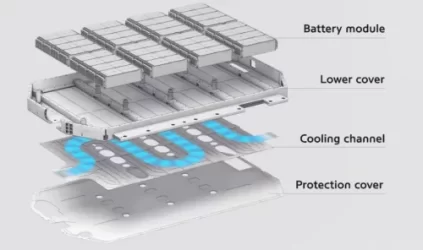

Your Ioniq 5 is completely totalled, and it is a known E-GMP design flaw that the cooling channel is directly above the plastic protection cover. I'm surprised there is no class action lawsuit as of yet.
