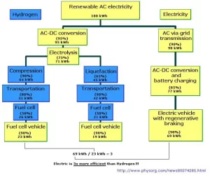

Because Hydrogen fuel cells are also EVs, it is very easy to compare the efficiency vs traditional BEVs (battery electric vehicles)
Lets compare the two technologies when they are supplies by the same source.
The issue with hydrogen is the generation, compression, transportation and delivery.
As you can see, it is NOT the solution for a green economy. Its marginally better than traditional ICE cars, but no where near battery electric vehicles because of the losses it occurs to reach the "pump"
If our entire transportation system was switched to Hydrogen distirbution, it will still be horribly inefficient and waste alot of energy.

The premise of this (the illustration) is wrong. It will always be preferable to utilize energy directly, but in a scenario where we will exchange out fossil energy with renewable energy, you have to calculate the most efficient system for stored energy as well. Hydrogen is just one of many ways of storing energy, but hydrogen's benefit is its a sector coupler. To remove CO2 from steel, glass, cement, fertilizer etc you need hydrogen anyway. That's why Green Hydrogen is included in any serious "Green Deal" futures energy modeling.
20% of current energy usage today is through electrons. The rest (80%) is coming through fossil energy and heat. Out of those 20% in EU, there is around (some times) 50% that is from Renewable Energy (RE). Last year Germany curtailed GWh's of power already at this point, so we have to be more effective in the way we utilize RE going forward.
Green Hydrogen will be one of many systems to do this, and once its stored as hydrogen, its more efficient to use it directly in a Fuel Cell, than to get it back to electricity and funnel the energy through the grid to charge up a BEV. Although this will in fact happen some times. The motorsport Extreme-E for example, which will be driven by BEV's will be charged up by H2. They will arrive to remove areas (Deserts, Greenland etc) to insert Pv farms a few weeks beforehand. This power will be stored through H2. Storing energy in batteries in 40 degrees or -20 degrees won't work, and will cost too much, so containerized electrolyzers to H2 is the solution. That hydrogen is then being used through a Fuel Cell, which is then giving power to BE infrastructure. This is basically a micro-grid, and something companies like Anglo America is looking at doing for their mines.
In any case. If the OP wants to calculate efficiencies, he have to start with energy that don't find direct demand. No electrolyzer will be ran to a point where the grids frequency falls down dangerously low. The point of them, and how they receive cheap PPA's and RE deals is because their demand is adjustable without problems. An energy mix consisting of fossil energy and RE will see prices fall when RE increases, and prices increase when fossil increases. Electrolyzers will increase demand when RE is increasing, and shut down demand when fossil energy makes the prices increase. In some cases, some H2-Hubs will have SOEC and PEM equipment to also offer backup power towards the grids for cheaper electricity deals. That means that when RE is coming to a complete stop, and the grid struggles, the electrolysers can be ran in reverse. SOEC and SOFC for H2 production and backup power is 90% efficient. Even more if they utilize the heat towards agriculture, or district heating for example.
In effect, that means that RE can suddenly give a pricing on elsewhere curtailed energy. If a RE producer have a H2-Hub between it self and the nearest inverter bottleneck in the grid, it can scale RE to fit both value-chains.
