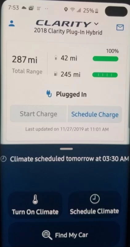

Right, i agree, but on mine the range is never more then 245. This is why I'm asking this question. Shouldn't I get more ?
This is right after I filled up.

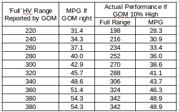

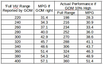

Just to illustrate, here is the range that could be expected for a full tank if the GOM is right, and if it is 10% high as has been generally reported...
