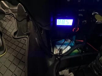

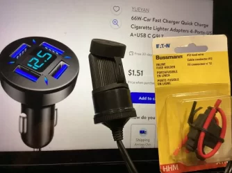

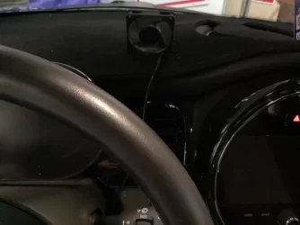

As I installed small computer fan to blow air into front windshield to dry any moisture and is running permanently as I drive but is shut of by car in 5 minutes and is plug into UBS port once car is park .My thermometer digital with probe is measuring temperature under a hood on top of inverter and is plug to cigarette port and this one is shut of after 13 minutes when I park a car .As I have this devices for 3 months no issues with 12 V. Accesories battery .And I’m sorry your charging telephone is debunked you have drive or live. Car with ready setting to drive to energize UBS or cigarette port .

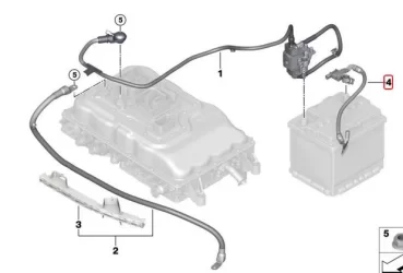

But if you DIY guy is simple to by pass going directly to 12 V battery with those 3 items on picture and few feet of wire going
directly to cabin is a rubber plug as you can snake through fire wall 2 nd picture
