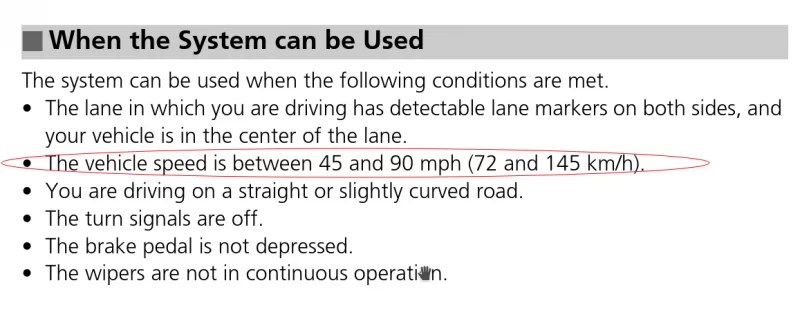

LKAS used to be available starting at 60 kph and now it refuses to engage below 70 kph. Also there were changes (for the worse, in my opinion) in how cruise control controls work. I posted about this previously here: https://www.insideevsforum.com/comm...um-lkas-speed-dispute-with-honda-canada.7224/

LKAS never started at 60 kph. 45 mph (70ish kph) is the lowest it has ever started. It will stay on slightly below that, but once it disengages you have to be 45mph again to restart.
I don't really want to get into this argument here, but mine did start at 60 kph when I bought the car in May 2019 in Canada (New Brunswick). I am as certain of this as I can be. For example, because there's no 70 kph roads in our city and I was testing LKAS before the purchase on 60 kph roads.
