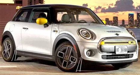

Ugh. I feel your pain. I’m going to order bright yellow RimBlades for my recently-acquired black Victory Spoke 16s for winter — one of which already has a tiny bit of rash. Hopefully I can be gentle on the summer Power Spokes.
It’s not that bad, but any imperfection is annoying and this is my first damage of any kind so it’s certainly sad.
I feel like someone here has mentioned some sort of touch up material that might help? Though I’d rather just leave it than apply a junky-looking fix.
Problem solved:

I had a clubman with the black wheels. 3 of them got curb rash, mainly because the vehicle was just a little bigger than I was expecting after mostly driving a Miata for 15 years. It became a real sore point for me. This is why I went with the gray wheels on the SE. I am liking the size of this car much more, so hoping to avoid curbing them.

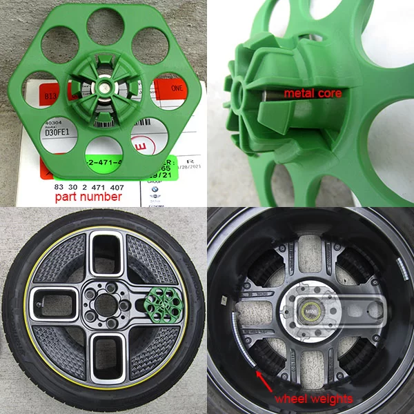

This is the Power Spoke balancing accessory--it clips into a hole on the wheel to simulate the weight of the asymmetrical wheel cover.
when you remove the cover on the power spoke, this necessary, but not provided! tool is shown on hte decal inside. Mini provides the key to remove the cover but not the more important balance tool?

However, they want to remove the wheels. If the wheels come off and go right back on where they were, do they need to be balanced with the special balancing tool? I'm not sure I can expect a wheel repair guy to do that sort of balancing, can I?
Trying this out before doing my two-year service, if it doesn't work then I'll see what the dealer can do for repairs or new wheels.
If they remove the wheels? Or the tires? If the tires have to come off the wheels, yes they will need to be balanced. If it's just the wheels coming off, no, and you can use the opportunity to rotate front to back and back to front (or some other pattern, depending on the brand of tire).

You should balance a wheels every 5000 miles to keep them last longer if they directional you switch them on the same side of a car front to rear on four corners a guy who come to your house in an artist to paint your scratches he got no means/ tools to balanced your wheels I never heard about with 50 years of experience.In my understanding only dealer can balance a wheels if they have that attachment and you don’t have one .Those wheels on SE is the stupidest design from BMW they ever come up with !
