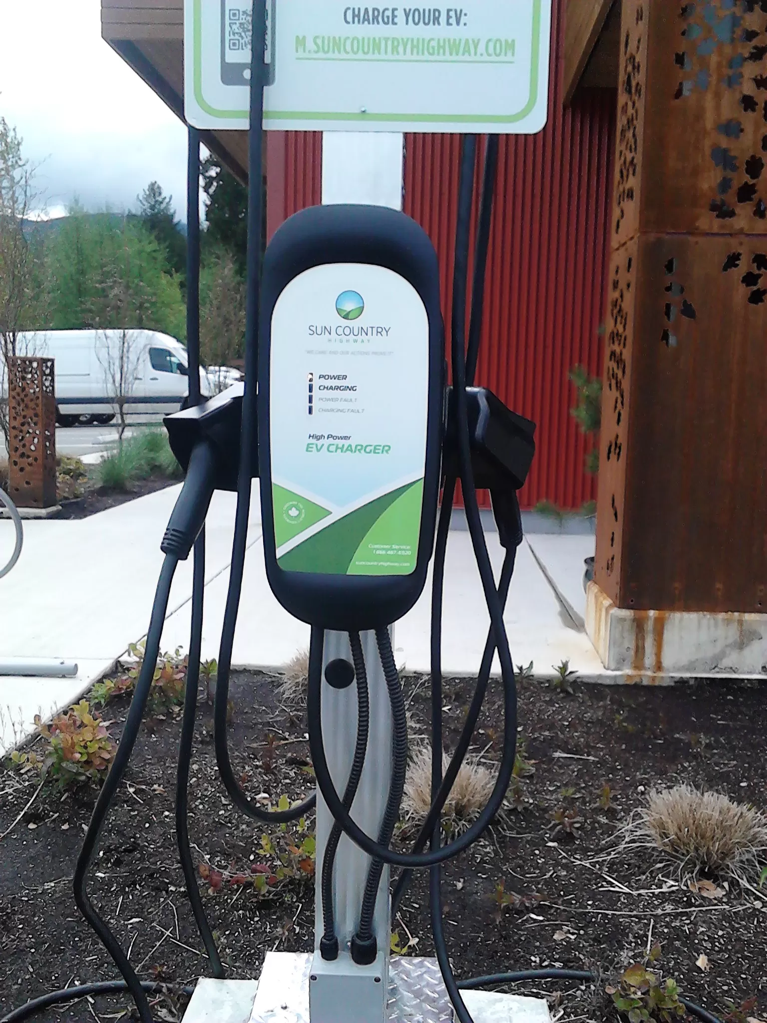

Ran into this little jewel, a newer free public EVSE close to my house.

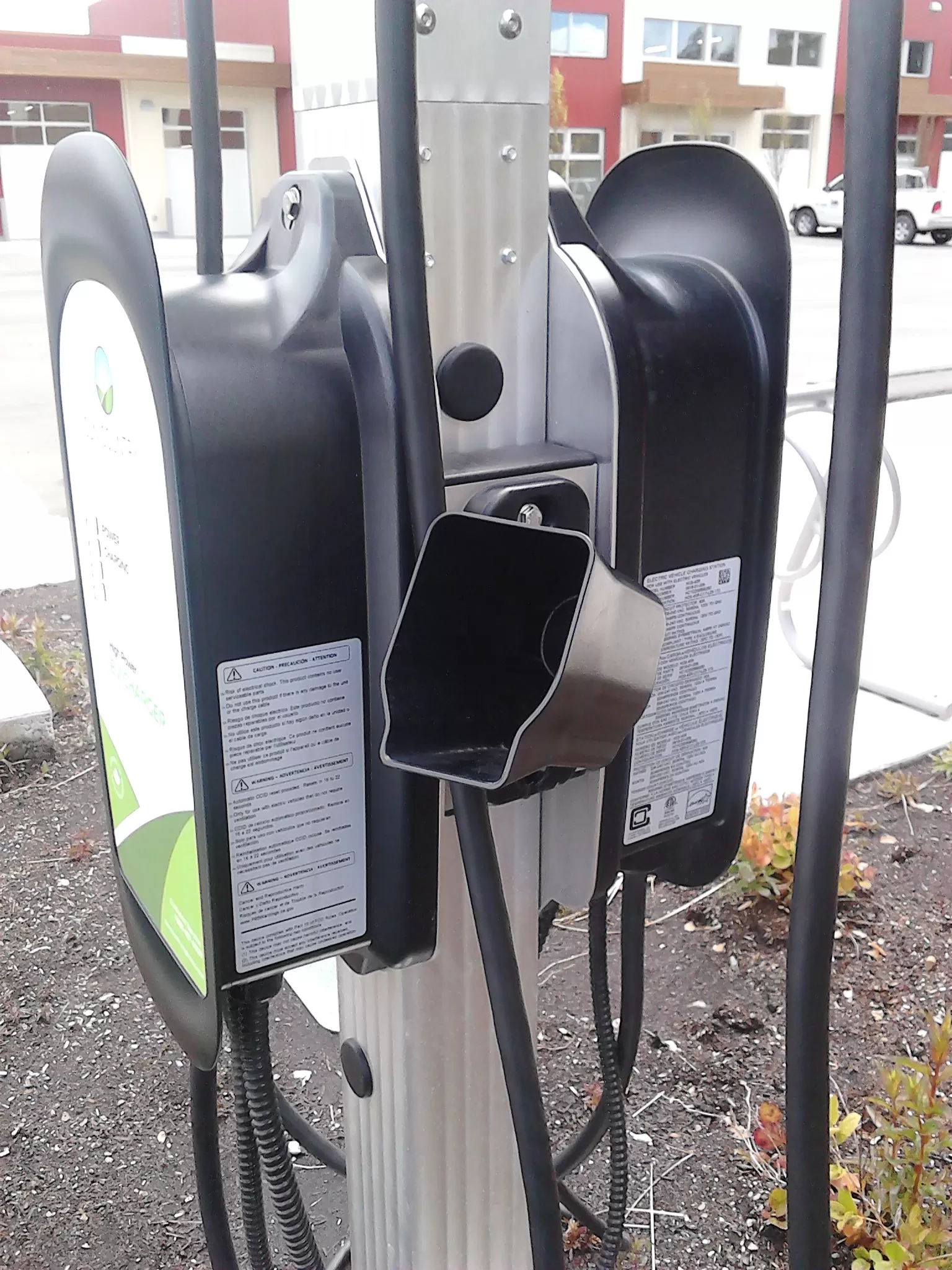

First picture shows the cord management holders pointing to the stars:

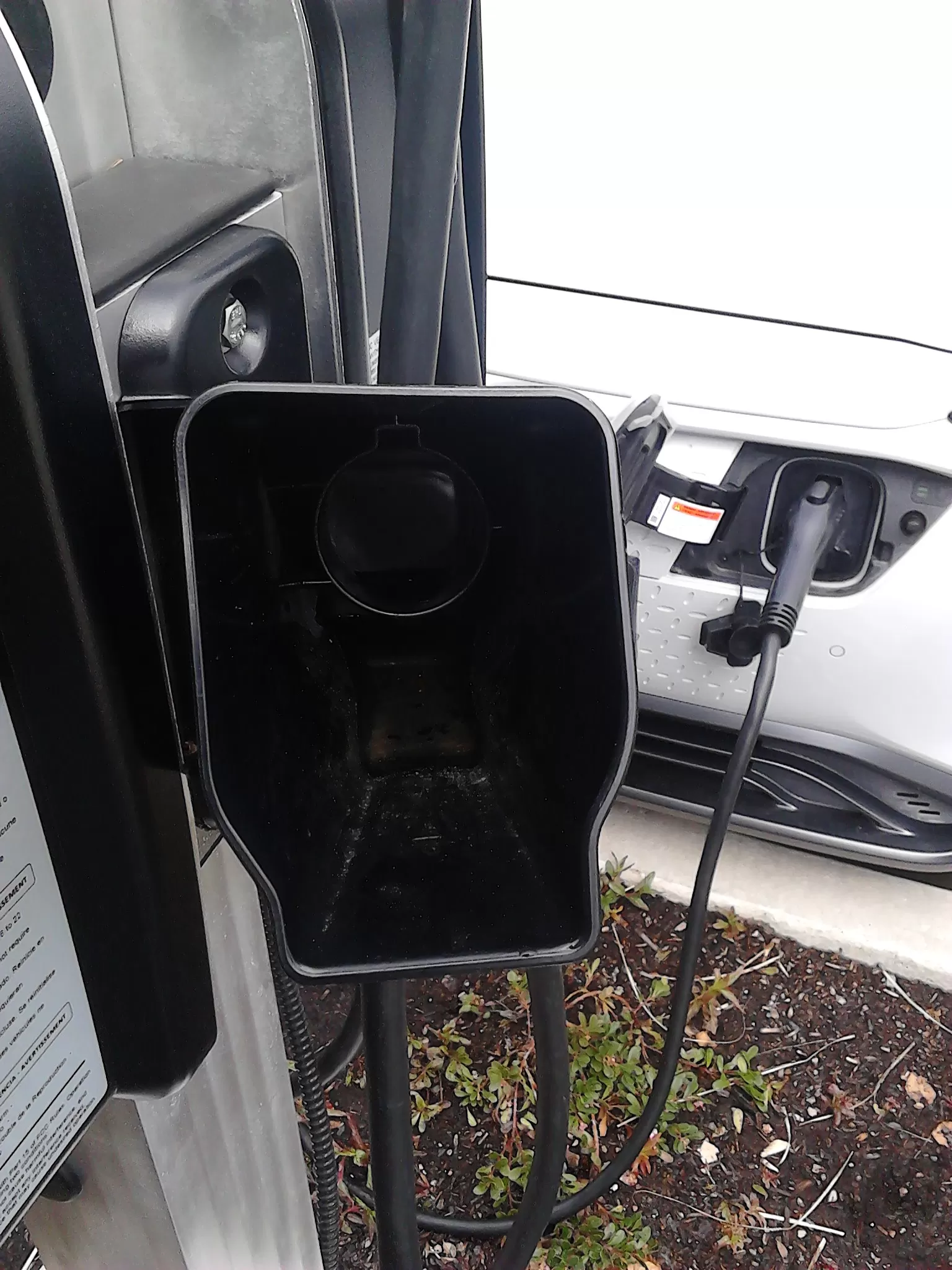

causing the J1772 handles and tethered cords to do the same:
rainwater gathering in the "cup" ensures the connectors/pins get a "good rinse" before plugging in:

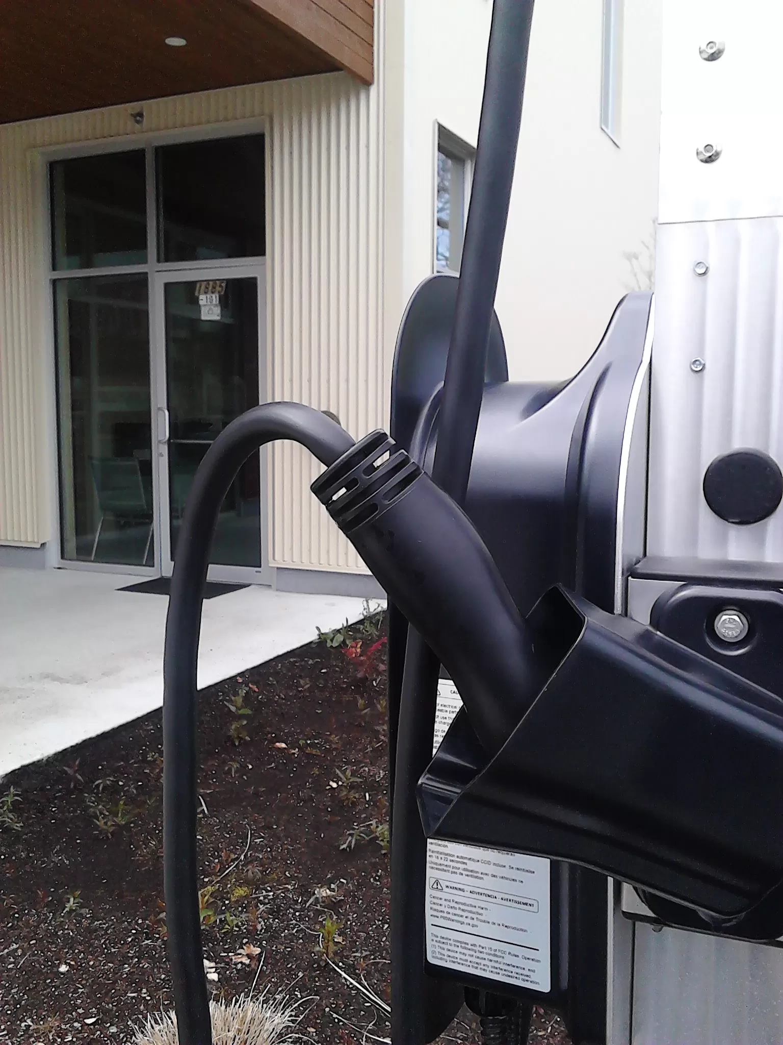

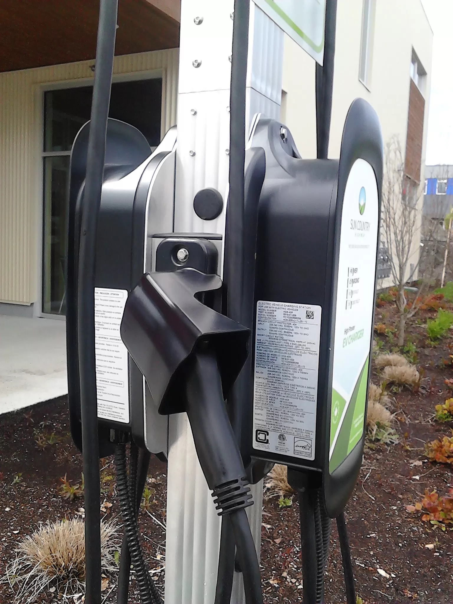

Dug out my 1/2" socket from the back, and did this to both management guides:
Now it looks a little more professional and indeed more functional:
