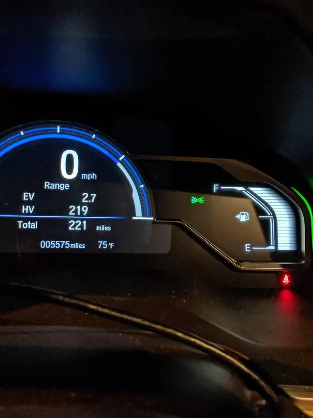

On a trip from LA to southern Utah, about 750 miles total using HV mode the entire trip with 3 adults and luggage and driving 75 mph most of the way we averaged 40 mpg.
As noted, and as with all things related to mile-efficiency. the exact numbers will vary considerably depending on driving conditions and habits, but Honda's website is more or less accurate, you are reading the numbers correctly, and the estimated gas range is showing low for some reason. With a full tank it will generally be somewhere in the general vicinity of 300 miles, and that's generally the vicinity of what you'll get unless you really lead-foot it.
The most likely reason is that it just hasn't calibrated yet, or the most recent driving was horribly inefficient (for example, you just drove up a long hill at 80mph or something). It will probably start to make sense eventually, or at least be closer. In general, though, the range estimates aren't all that good in my experience--they bounce around a lot and tend to be high at least with my driving pattern.
If after you've driven for a while and filled up a couple of times you're still getting garbage numbers, take it to the dealer and see if they can figure out something. Alternately, pay attention to miles-between-fills, and calculate to make sure that you aren't genuinely getting terrible mileage for some reason, which would indicate a mechanical problem.
Just to note, there was a significant bug in the other direction in the original-release software that would cause the gasoline range to be calculated based on the total average miles driven, which if you drove primarily EV would result in the range shooting up to 1000 miles the first time you filled the tank. That was fixed in a software update eventually, though, and since your car is new it should already have that applied (plus it usually resulted in high range, not low).
Bought a 2018 Touring PHEV a couple weeks ago and am loving it so far! Don't get to charge too often, but I do get free charging at Uni during semester.
Now, I just did a full tank and noticed the HV range was marked at 219 miles.
On Honda's website describing the range, it says:
Combined Gas-Electric Driving Range Rating: 340 miles
Maximum EV Mode Driving Range Rating: 47 miles
Does this imply that Gas-only would be 340-47=293mi?
If that is the case, why does my range only show 219 miles after a complete fillup? Am I reading the numbers wrong?

Yes. Actual range always varies but when you charge just one extra time/or 1 less time in a given estimate thats about a 18 percent change in actual range either direction.
