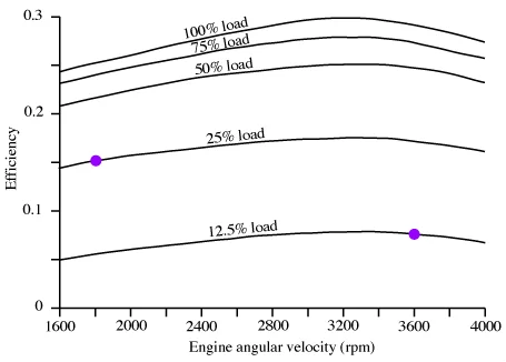

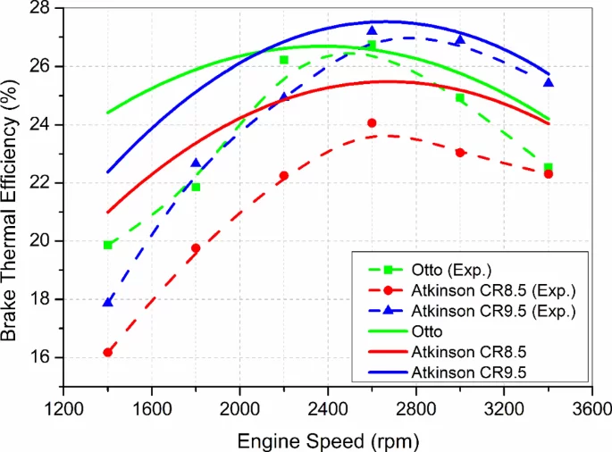

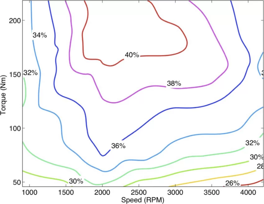

@Landshark ... A couple of graphs that might at least help you believe that what has been described is possible. At low power demands in HV mode, the engine may be running at low RPM and on a relatively low power output. Increasing the power requirement of the engine by turning on HV Charge may increase RPM and increase the engine loading, both of which could increase engine efficiency if it doesn't move beyond the sweet spot on the RPM curve (looks like it may be something like 2600 to 2800 RPM for the engines in the first graph).
This graph is for a diesel engine, but it shows the principle - the colors are efficency contours. Increasing RPM and increasing engine loading causes an increase in efficiency, up to a point (note the sweet spot of RPm at 2000 to 3000 and torque above 150 Nm - area inside red contour):

Agreed efficiency could be part of that tiny mpg improvement also, but as I said on the highway it is likely negated by losing the ability for direct drive. Generating the electricity then using the electricity in the motor probably has a 10-15% inherent loss.

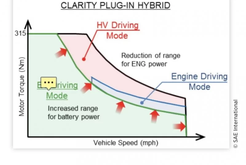

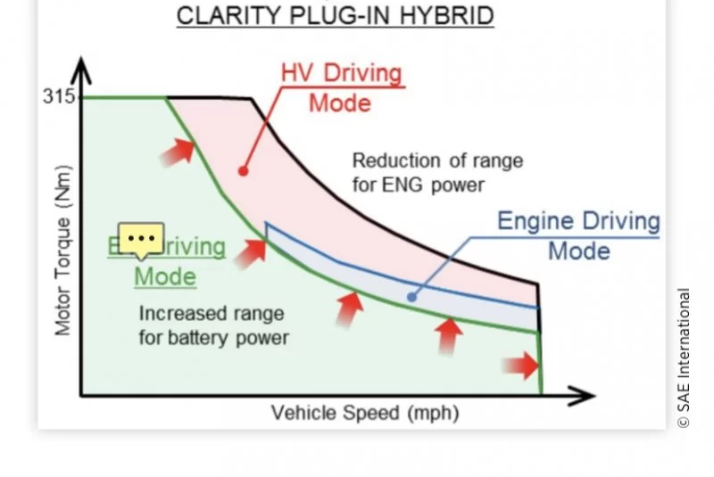

I’ve posted this graph before, but it may be worth another look. EDM operates within a very narrow window of torque and it must be within that window at a certain speed as well. Both conditions must be met. Similar to holing a putt in golf.
Isn’t it true that south of Orlando, the highest point in Florida is a freeway overpass? Even on a slight down hill stretch, or at some other point where it might not be expected, one of the conditions, most likely torque, will not exist and the vehicle will disengage from EDM. Heck, it might even go into EV Mode for a few seconds.
Isn’t it true that south of Orlando, the highest point in Florida is a freeway overpass? Even on a slight down hill stretch, or at some other point where it might not be expected, one of the conditions, most likely torque, will not exist and the vehicle will disengage from EDM. Heck, it might even go into EV Mode for a few seconds. View attachment 20488
Haha yes, and yes it does go into ev mode for a few seconds if using the cruise control. It is possible much of the time to avoid leaving EDM going down the overpass by increasing speed, but obviously this is normally not worth the hassle.
One variable I don't see on the graph is temperature, which was a huge factor for EDM engagement when I lived up north. EDM would only engage maybe 30% of the time for many ski trips to Vermont. Or maybe low temperature is just increasing the required torque and thereby moving out of EDM range?
