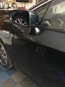

Mine does both directions. See photo. No damage.
