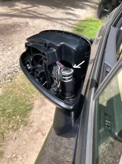

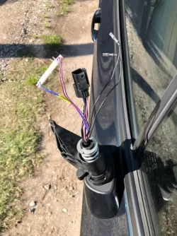

I tackled this repair today. There was an unfortunately placed trashcan that the mirror smacked and got knocked apart a couple weeks ago. Fortunately it snapped back together and I was able to order a the parts I needed from hondapartsnow for about $110. (as an aside looking at their prices - the most expensive part of the entire passenger side mirror is the dang camera at around $350...that's bananas).
Because I was only repairing the lower case of the mirror, and the body colored top portion - I didn't need to remove the door panel, though I did preemptively just in case I needed to pull the whole mirror.
Steps of disassembly:
- remove mirror glass and disconnect heater wires
- remove top cap
- unplug and remove side watch camera (one screw, and two clips.
- remove mirror motor assembly (3 screws)
- unplug mirror motor (used a small flathead screwdriver)
- depin mirror motor plug (smal pick to push back clip, slide directly out -- it does not pull up, it slides out - see mirror_motor_plug and weird_mirror_motor-pin)
- depin camera plug (this is the big plug that Bob had to fight earlier in this post). [1]
- use needle nose pliers to set into the notches in the spring retention washer and turn it until the flat spots align with the flat spots in the post (assuming your post didn't break anyhow). The spring is under a good amount of tension so be careful.
- remove the washer and spring and lift the mirror housing off of the post. (I found wrapping all of the wires up, 12 in total [6 for the camera, 4 for the mirror motor, and 2 for the mirror heater], with electrical tape made dealing with moving them through the spring and washer and such much less painful).
- continue disassembly to swap over whatever you need to your new parts and finally:
- reverse order to reassemble.
** Gotcha: after you've finished your repair, like any reasonable handyman you'll want to make sure it works before completing reassembly. The mirror and window do not work if the passenger door window and lock switch are not connected.
It wasn't terrible and was a fun handy way to spend a few hours. Even if you're not repairing your existing mirror and are replacing the whole shebang, you'll need to depin the camera connector to get the wires out of the mirror. (It's a pretty crummy design honestly) -- addendum: actually looking at the pdfs shared earlier, it looks like there is another clip inside the door that you could unplug instead if you're replacing the whole mirror. The pain I went through may just be limited to the frugal who are repairing instead of replacing ^_^

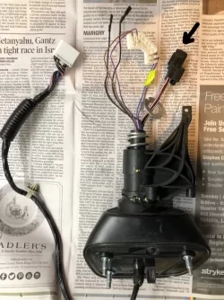

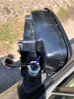

I have a very similar dilemma though slightly different issue. I hit a construction cone about a year ago that destroyed my glass mirror and a couple issues including the housing for the camera and broke the mirror cover (typically colored same color as the car)
after getting the cover and the glass mirror replaced, cosmetic is the only issue and the camera isn’t housed in place so last week I decided to buy the rest of the parts I need.. the housing and the camera holder black plate on the bottom.
After removing the housing, I’m now baffled with an issue where I cannot install the bottom black plate that houses the camera at all.
Any ideas how I can get that part on?
You have to disassemble the entire mirror, including the retention spring that is on the post where the mirror pivots from to replace the bottom part of the housing. There is no other way to get that part on as it is in effect the second item in the stack of parts that all ride on that post. The round hold next to your hand in the second image that is opposite the opening where the camera mounting plate snaps in is what you'd be sliding down the post once everything is disassembled.
