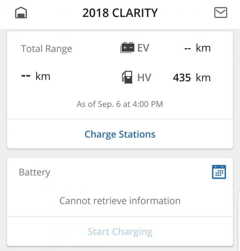

My Hondalink is no longer refreshing my remaining mileage or charge status. Tried reinstalling , rebooting car , nothing works .

Still can't get Honda link to refresh charge status or remaining mileage. I've reinstalled app, connected to the car , rebooted car, re-registered car in the app. Cannot get the thing to update .
Clear cache/data for the app on the phone?
Worth a shot.
Good luck!
Nope still doesn't do anything . The odometer and location do update but the charge status and the range do not. Frustrating as it was working for over a month.
Just realized it coincided with the first use of my home chargepoint fast charger.
No I haven't tried another charger. I'm going to try the Honda 120v wall again and see what happens .
I don’t think it’s the ChargePoint. I have one at home and have been charging on it for 6 months and my HL never fails to update.
Yeah I don't think it's that either. Few questions about chargepoint since you have the same charger. I usually get 7.2 kW as the charge rate, is that what you observe? It would be great to have an option to stop charging if the charge drops below let's say 2kW as I don't need the last 5 to 10 min of the top up. I should send a suggestion as it would allow me to hit full Regen quicker :)
Update, everything is working now but I have no clue what fixed it after 9 days of not updating. The only thing I did differently that I can tell is I removed my phone from the bluetooth list and re-registered it. A day later it is working again, not sure if that did it or not but its worth a try.
