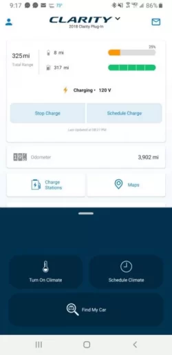

I just updated the Android version of the HondaLink app. I'm not at all bothered by the loss of the infamous EV Charge percentage, but I am concerned with the persistent Notification that HondaLink is Connecting, with the only option being to Dismiss it. The data shows after I Select Dismiss, but after I exit the app, the Notification continues. Even if I select the Notification to be minimized, it still persists.
That looks like a possible battery drain issue.
I just noticed that in Settings/Apps & Notifications/App Info for the HondaLink App showed a double Notification selection - both shown active. I turned off the second one, and I'm not seeing the persistent notification. Not sure what other effect that may have.
I got the iPhone update a couple of days ago (without asking for it) but I can still see the percentage. Weird.
Well, spring in New England means that the temperature has always changed recently :) . It was chilly this morning and I couldn't start the heat with either the app or the remote while it was still plugged in (@120V). After unplugging, I could now use the app to start heating and, as expected, start draining the battery. After 10-15 minutes, I tried plugging back in and now it continued warming while maintaining charge.
So, with the current version of the app, I can unplug, then start heating and then plug back in to stay charged. Less convenient than a scheduled conditioning available with 120V before, but better than nothing. Maybe Honda will update the settings again so you can always use 120V to maintain SOC during preconditioning. Or maybe I'll have an L2 charger by next winter.
I charge with L1 and mine has been more finicky since the update (Android). It won't turn on PC if the car is still charging. I have had consistent success stopping the charge, starting PC, and then restarting the charge. Sometimes it will even resume charging by itself.
