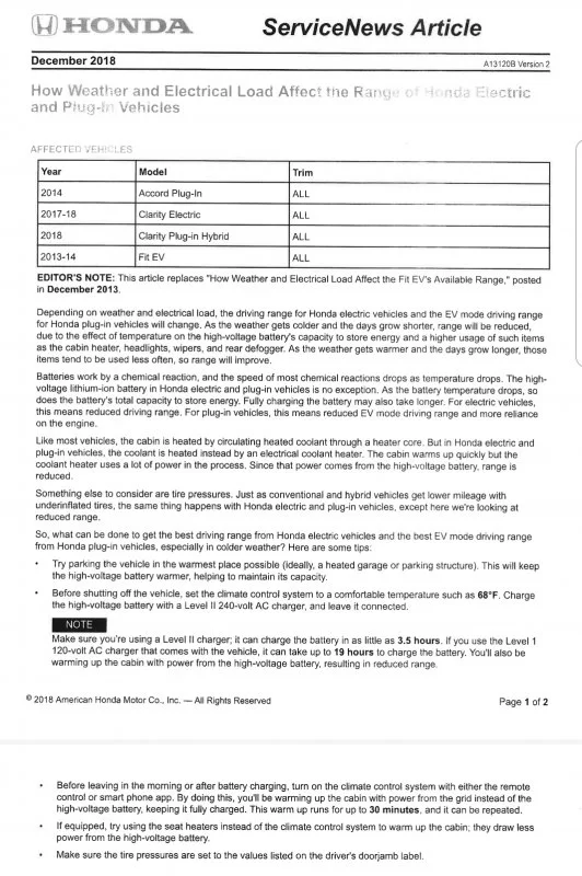

Not been getting over a 40 mile SOC and complained at first service. Was given this....
Could be but had car in hot and very very cold. Charged all ways and locations.
Is 47 a dream?

@Sthomasa - Welcome to the forum !
47 is NOT a dream...
The Clarity, like all other EV's will perform differently based on usage and weather (seasonal) conditions.
When it is 'cold' the battery performance degrades, and heater use has an even larger impact.
You will find a LOT of discussion about this in the forum. I would summarize to say you can expect to see the EV range vary about +/- 10 miles from the nominal 47 (as low as 37 miles in the winter, and as high as 57 in the summer). I think Honda is right on the mark with the 47 miles as an annual average.
This assumes you live in an area where it does get cold in the winter...
It is highly likely that your car is perfectly fine.

This is right on. If you're not averaging roughly 47 mpc over a year (all four seasons), re-assess your driving style or your use of the modes. If you never see an estimated range of over 40 EV, then try experimenting with different modes and/or different use of the accelerator and brakes. Just for fun, sometime in an area of light traffic, try driving as if you have no brakes (hyper-miling).
In warmer weather I get far more than 47 and far less in colder weather. 47 electric range as an average is very attainable.
Driven 16,000 miles since June. EV SOC high point was 66 in August, low point is consistent 32 for last month during Wisconsin winter. High SOC estimates proved pretty accurate with odometer mileage checks, but we can get a little more (10-15%) than the winter SOC with optimal driving behavior (using preconditioning, modest speed and acceleration, etc.).
Since I live in a warmer climate, my winter low is about 41, summer high upper 50s, maybe 60s if driving smoothly and slowly...
