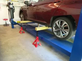

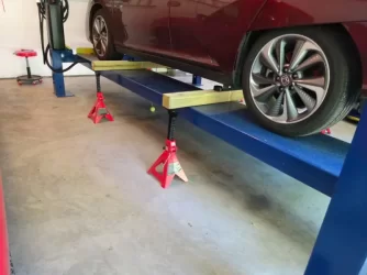

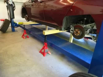

Or, instead of a new jack, buy a lift ! I just rotated my tires earlier today.
With a 4-post lift, I can raise the car, set up 4 jack stands with 4 x 4 beams, then lower the car onto this arrangement to gain access to all 4 wheels at the same time. Of course a 2-post lift is more straightforward, but you can't use what you don't have !

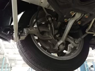

Perhaps the ribs and channels designed to lighten the suspension inboard of the wheels may not offer surfaces that will support the Clarity as well as the ends to which the wheels attach.
In absolutely no way do either the front and lower suspension arms for the Honda Clarity PHEV provide any support of the weight of the vehicle. These arms support loads (forces) that are, for the most part, solely in a plane parallel to the ground. The weight of the vehicle (a force) goes through the springs directly to the hubs then through the hubs to the wheels and tires to the ground. The front suspension is a McPherson strut type while the rear suspension is a neat five link type described elsewhere in this forum:
https://www.insideevsforum.com/comm...link-rear-suspension-of-a-honda-clarity.7320/
Furthermore, a jack cannot get to the hubs (or suspension arm outer ends) on a Clarity PHEV because those hub points are well inside the wheels.

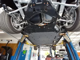

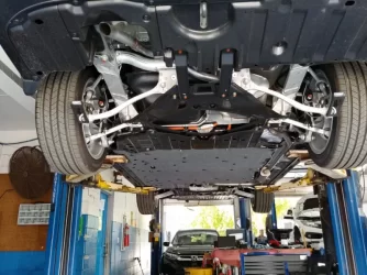

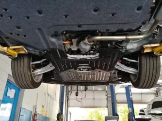

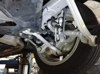

Quite a whole back, somebody posted a LOT of photos of the undercarriage of a Clarity.
You can see from these views why the rear suspension parts are probably not a good place to be jacking...
They are odd shapes at odd angles, and the ends are too close to the wheels to position a jack properly.
Here are some rear views (Note the center lift point at the top of the 1st photo.. Pretty convenient):
And here is a view of the front. Again, the suspension parts - not so good for jacking.
The central lift point is forward of the Catalytic Converter and Aft of the oil-change cover:
The Honda Predelivery inspection service bulletin is quite specific about the allowable jacking points (the two central points MrFixit describes above and the four side lift points (as described in the owner's manual and in MrFixit's post above):
"Get familiar with the jacking and lift points shown below. Use of any other points can cause deformation/damage."
