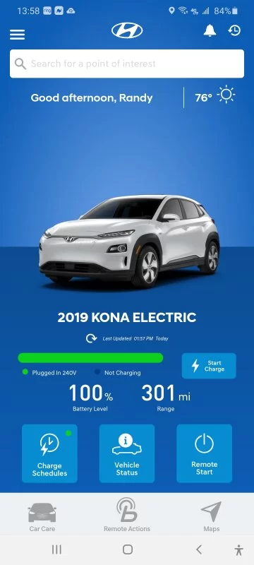

Note since I wrote the last post# 8 in October 2019 I have done testing and it has been confirmed by others as well that the level 1 EVSE that came with the Kona can charge at 240 volts giving 2.8 kws. It is sill limited to 12 amps but at 240 volts it will give a nice 20%- 80% charge over night. It appears that he same charge is used in Europe on 240 volt 50 hz though it is re labeled as a 240 volt charger. I have charge my car using the the EVSE that came with car and an adapter to 240 volt and it charged the car in 12 hrs. So it is possible. I can't speak to long term reliability at 240 volts because I only tested the one time as I also have a level 2 EVSE.

When I had to plug in the wall everyday I used to run the battery further down and charge up higher, but now I can just click on so conveniently, I'll usually recharge after each day's commute and keep the battery around 80%. Recently I did a full charge with the results shown below after 25K on the odometer.
