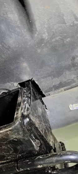

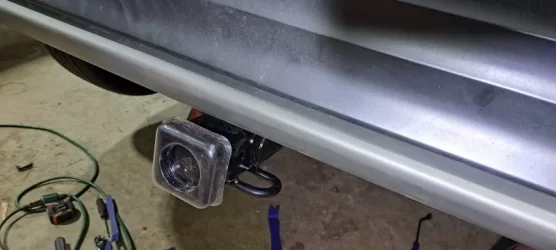

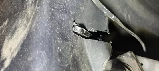

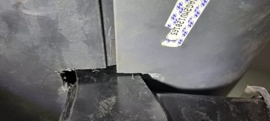

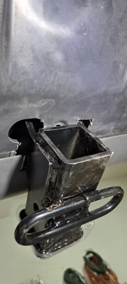

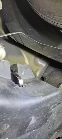

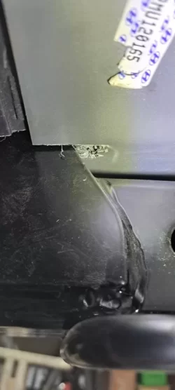

I just installed a 2" trailer hitch on my 2021
DrawTite DT52GR
Install is doable solo but would be a lot easier with a second person.
Mods to the bumper trim and bumper splash shield are required but are simple and easy.
