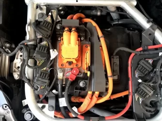

I think its very likely that the noises are all actually coming from the electronics in the engine bay and what you are hearing is the little amount that gets through the firewall and HVAC ducting.
A good example of how much noise the motor/inverters can make is the stripped Unplugged Performance Model S for pikes peak

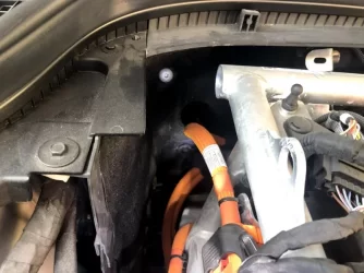

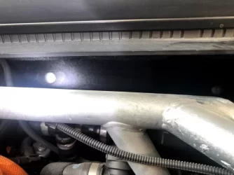

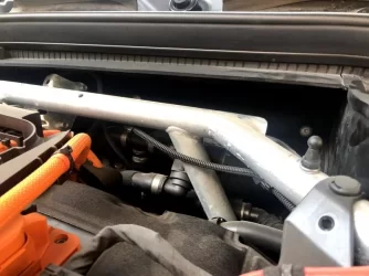

I did some more digging and found that the SE already has soft materials for absorbing high frequencies covering the motor, inverter, on the firewall, on the underside of the hood, and even under the vehicle where noise would reflect off of the ground. I think it just needs a lot more for my taste.

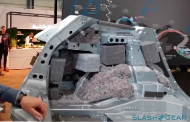

The Mercedes EQC uses giant pieces of lightweight acoustic cotton insulation to absorb these sounds. My thinking is the entire engine bay would need to be filled in. It might be possible to make a single giant insert that would fit like a puzzle piece, filling in all of the gaps.

Whatever material you use, definitely make sure it's fire retardant and non-absorbent! I guess the other thing I'd be concerned about is heat. I think the inverter is probably liquid cooled but some of the other electronics are probably just air cooled and may not be too happy wearing a blanket.

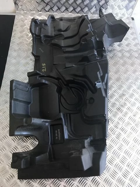

BMW and other manufacturers use giant cast blocks of acoustic foam over the engine in their ICE cars, it would be possible to make something similar for the SE if you could figure out what material they use:
That's just what I'm looking for! Of course there are a lot of unknowns with heat and airflow like you mentioned.
