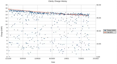

I keep a very close watch on charge consumption... Over my 3 years of ownership, I have now charged the Clarity 547 times. Not all of these are 'full' charges, but many are. Here is a graph that includes every charge. Your eyeball can visualize the trend over time for the 'full' charges. These numbers are reported by the EVSE so they represent raw power input to the vehicle. In my case, a full charge was initially running around 14.4 kWh and it has tapered off such that currently a full charge is more like 13 kWh (about a 10% drop):

Thanks Mr Fit it. Your first link/chart seems to indicate your kw consumption per charge these days is between 12 and 13, as I think mine is too. If I’m interpreting it right? So I’m taking my car as degrading at a normal rate, if you think yours is too…
Yes. The precise value varies because the SOC is around 10% when you reach 0 EV range.
It will be plus or minus a few percent depending on how you were driving after reaching 0 range.
I agree that 12-13 kWh of input power is in the 'normal' range for a 3 year old Clarity.

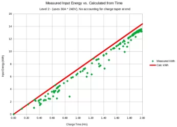

As a contribution to the discussion about 'measuring' the input energy from charging time, I had a thought...
If your EVSE reports the total energy, that is nice, but if it is very coarse (like the reported Musquirt unit), then perhaps it is better to calculate the input energy from the charging time (as illustrated by @craze1cars above).
Energy is voltage * current * time. At a Level 2 charge rate, the Clarity uses 7.2 kW (240V @ 30A). If you simply multiply the charge time (in hours) times 7.2 kW, you can get a good estimate of the killowatt-hours, BUT there is one small caviat. The Clarity tapers the charge at the end, so there is a short time at the end of a charge cycle where the rate drops 'slowly' to zero. I have always attributed this slow drop-off to cell balancing, but this is speculation on my part.
My EVSE provdes both a charging time and a measure of kWh (with fine resolution). Using my last year of data, I could plot the kWh both ways (measured, and calculated from charge time). Here is the result:

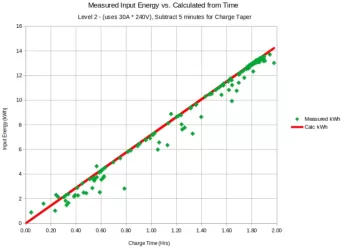

There is an obvious bias where the actual energy is noticably lower than what is calculated from the charging time. This could be due to the tapered charge during the final minutes, and if you throw in a correction by shortning the time by 5 minutes, it looks better:
It is interesting that lots of the points fit the calculated curve very well, but there are also numerous points that don't. There may have been a few (very few) points where I terminated the charge early without allowing the tapering. This would yield a point higher than the curve. The ones below the curve could have required an extended tapering / balancing period?
My conclusion is that the best way to estimate input energy from charge time (Level 2) is to subtract 5 minutes (0.083 hours) from the charge time and multiply this by 7.2 ie: Energy (kWh) = 7.2 * (Charge_time (hrs) - 0.083). I would like to better understand the points that fall short, but that will require significantly more effort.
