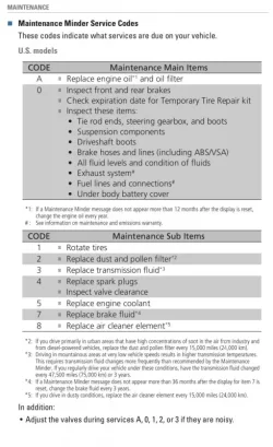

Spark plug replacement & valve clearance are maintenance minder item 4.
Below are the details for MM #4. It’s just an “inspection” for the valve clearances. The footnote calls for adjustment during A, O, 1, 2 or 3, if the valves are noisy.
To me, this seems like an odd way to define this...
Does Honda really intend for MM #4 to include disassembly of the valve cover and measuring the clearances?
Why not just let the footnote be a blanket statement to adjust the valves during any service operation if they are noisy?
I suppose there is some merit in actually measuring the clearance at some point (maybe when the plugs are due makes sense) because the 'noisy' test will not detect if the clearance is too tight, in whch case, they should be adjusted...
