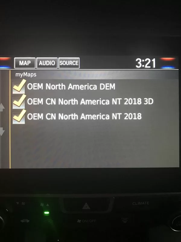

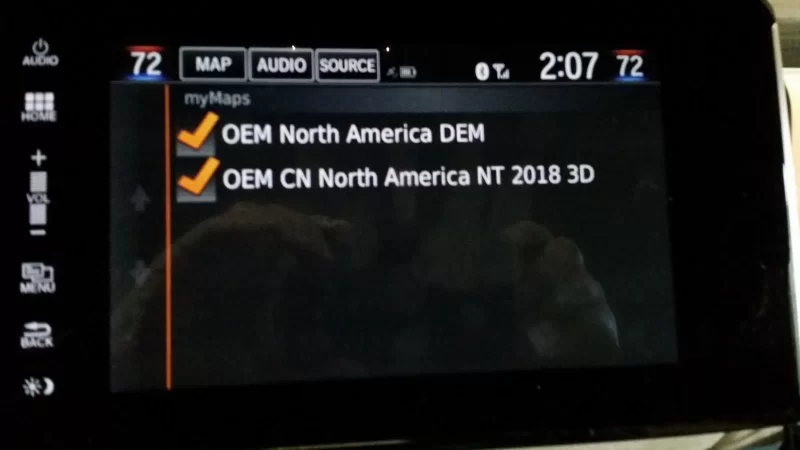

I think I may have a clue to my map problem. Can someone please check to see if their Clarity Navigation myMaps page (after the map update a few months ago) has three maps, or just the two in my post above. If three, a screen shot would be much appreciated. Thanks very much!!
Thanks very much Ken! You just confirmed my suspicions.
I believe that I lost a map (the one that contains all the detail on local roads) in the update I did in Feb. I'll try to do another update to see if it can be recovered.

I did some checks over the weekend with other Clarity (Thanks KentucyKen!!) and CRV owners. They had all 3 maps under myMaps, while I had only two. That was a key clue!
I reapplied my previous map update already downloaded on my USB memory stick in Feb. (without going back to the Garmin Express map down-loader.) I now have 3 maps showing in myMaps and the missing detail is no longer missing.
My guess is that my previous update was downloaded OK from Honda/Garmin to my USB stick, but did not properly install all 3 maps in my car. That may have been due to my error.
