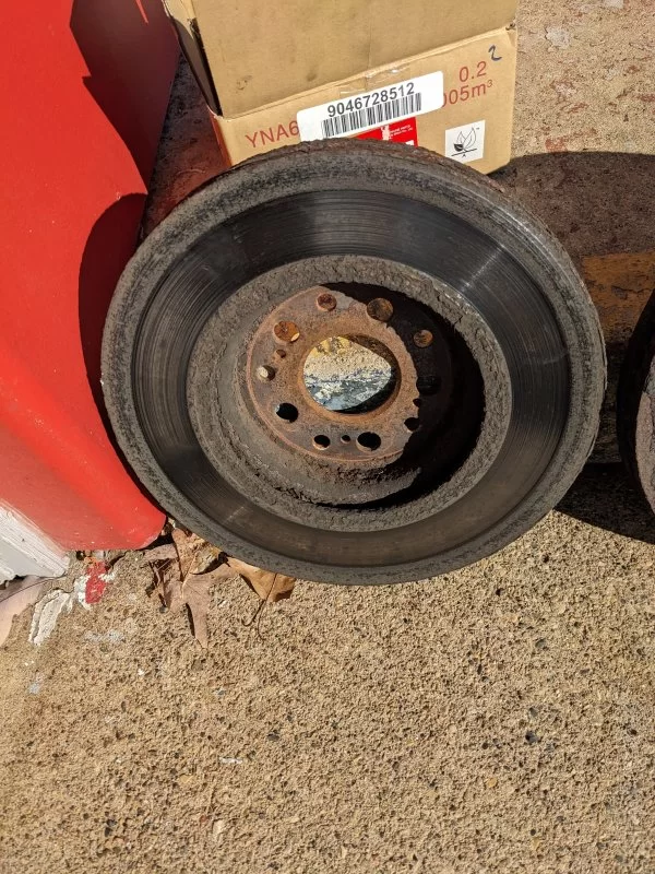

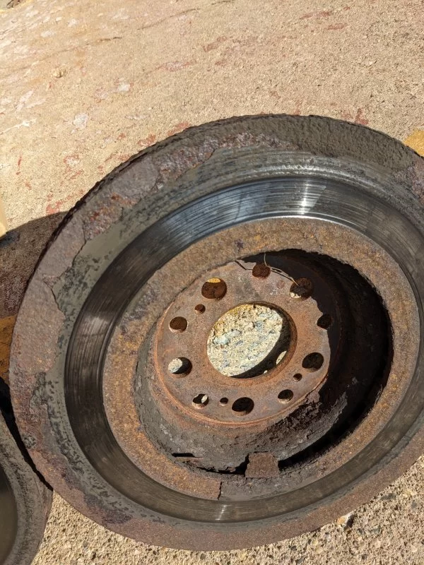

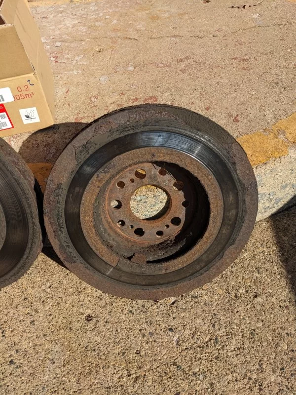

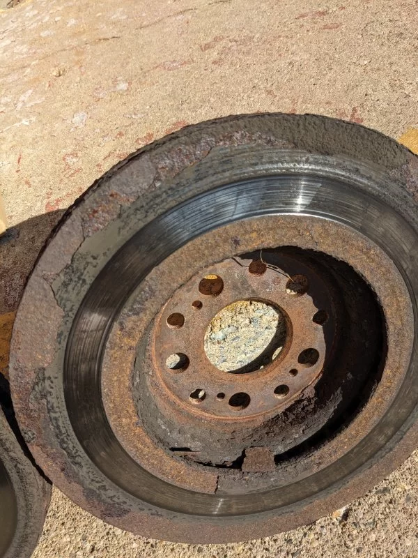

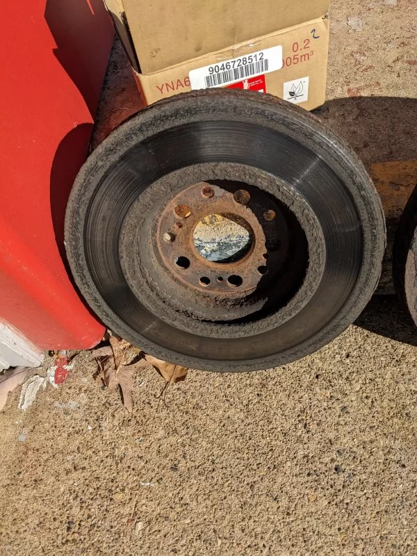

Pictures of the rotors.

Pictures of the rotors.View attachment 23436 View attachment 23437 View attachment 23438
Those rotors are astoundingly bad, I wonder if this is a defect, and not just the combination of Regen braking with crappy parts.

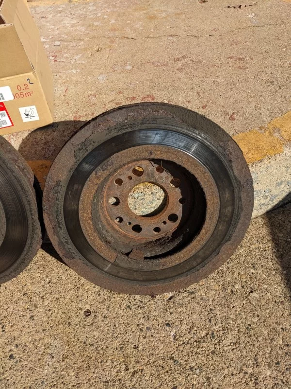

This looks to me like you are using regen for 99.9% of your braking and the brake pads had not yet even broken in. Nothing to do with heat. Forget maintenance mode. Brake pads have on top a pyramid shape which transitions to the full area as they wear in. This looks like you never got anywhere near the end of the pyramid shape, so much of the rotor area has never even been exposed to the brake pads. So it has just sat there and rusted. I suggest with the new rotors make sure within the first year you get all the pads fully in contact with the rotors by doing agressive braking on a regular schedule. At that point the shiny contact area should extend almost out to the full diameter of the rotors. And make sure you keep using the brakes after that, not just regen. Keep it shiny.

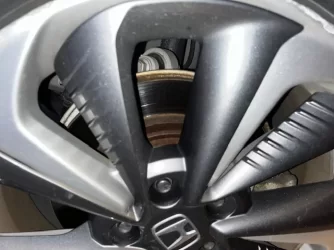

Well then this makes no sense at all to me. Here is what my rotors look like after 6 years and 90k miles, you can see the shiny area (brake pad contact area) is much wider than on yours.You showed only one side of the rotors in your pics, I assume the other side looks similar?

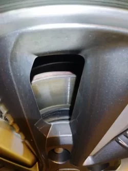

Here is a picture of my rotors (2018, with 6 years of use, fairly low mikes - 44K miles, Garage kept in Maryland):
These rotors look practically new with no evidence of any structural corrosion.

I have to agree, I was grasping at straws to try to come up with an explanation. The fact that the OP now says that the out side of his discs are fully shiny, while the in side is a rusty mess, leads me to another guess that the in side pads are being affected by corrosion, and are sticking and therefore not applying quite as much force as those on the out side. It does seem possible the in side could get significantly rustier from road muck buildup. Did the mechanic change the pads and clean and lubricate the calipers too I hope? It would be good to know if the in side pads had less wear than the out side.

Look at the inner side of the rotors
