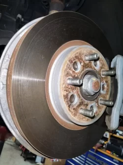

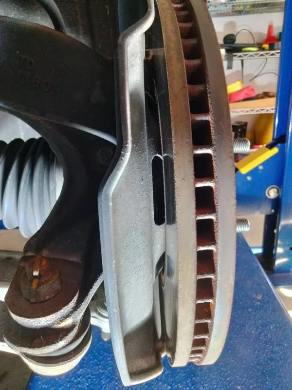

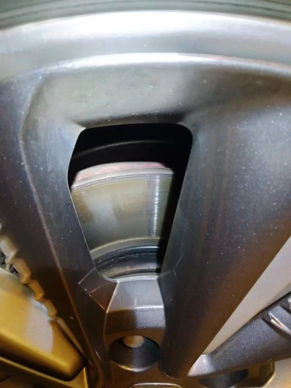

Here is a picture of my rotors (2018, with 6 years of use, fairly low mikes - 44K miles, Garage kept in Maryland):
These rotors look practically new with no evidence of any structural corrosion.
It seems to me that this has to somehow relate to weather / atmospheric conditions where the vehicle is located.
I'm not saying that there isn't something better that Honda could have used, but the rotors are performing extremely well for many (most?) of us, and it is a mystery as to what / why this is happening to some...
For those who are experiencing this bad corrosion - Can you comment on your experience with other vehicles? Do all of your vehicles suffer from poor rotor performance? Or, is it a combination of atmospheric / weather conditions exacerbated by the relatively low brake use of the EV?

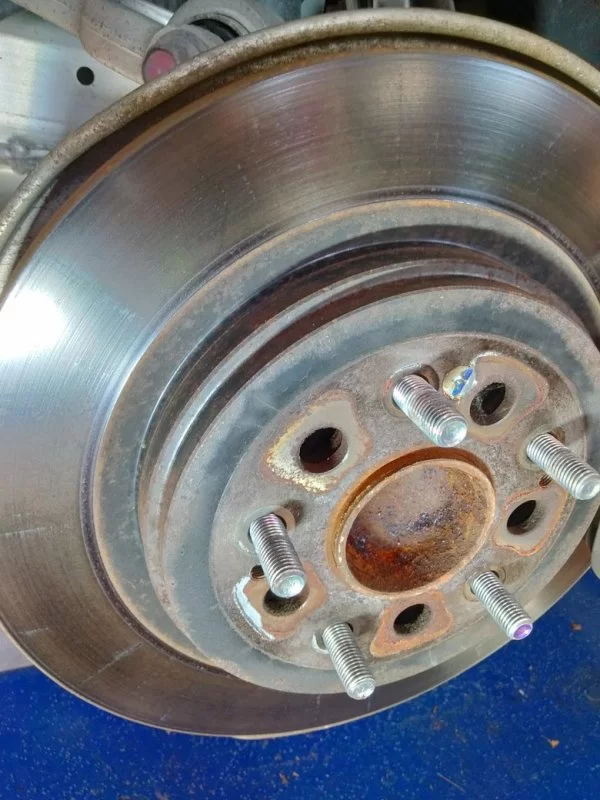

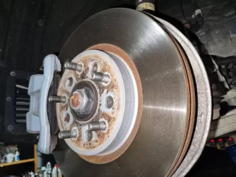

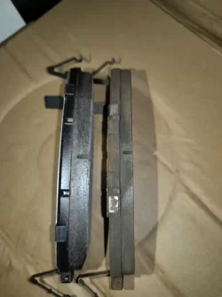

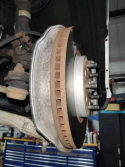

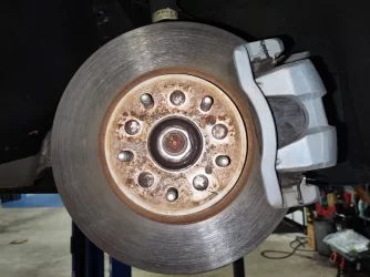

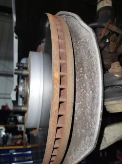

I was working on my car last night so I took some pictures of the rototrs. These are the front rotors which are Raybestos Specialty Street Performance Coated rotors. Here is a link: https://www.rockauto.com/en/moreinfo.php?pk=10622856&cc=3441908&pt=1896&jsn=909
I installed them in August 2023. So they are just over a year old. I have put about 28K miles on them so far. I did resurface/cut them after replacing a frozen caliper. Overall they are holding up well for New England roads. They are slightly warped again but not terrible. I might cut them again or replace them soon. I am hard on brakes so I am accustomed to rotors warping. I might try drilled and slotted rotors next but I am not sure I want to. I haven't had great experiences with them in the past.

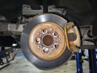

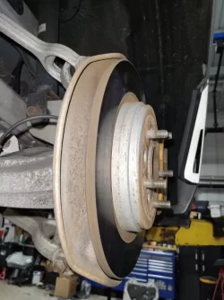

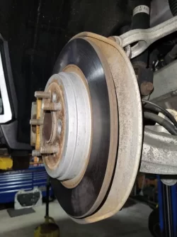

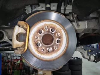

Here are the rear rotors. These are Powerstop Evolution Geomet coated rotors. Here is a link: https://www.rockauto.com/en/moreinfo.php?pk=11908909&cc=3441908&pt=1896&jsn=903
I installed these in January of 2023. I have put about 43k miles on them. I had painted the calipers then as well. The road salt has ruined that already. I think these rotors have held up fairly well especially considering how cheap they are.

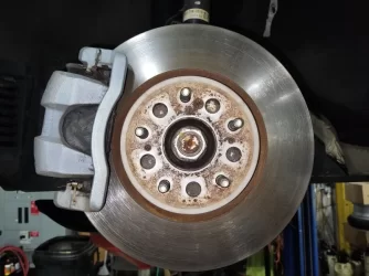

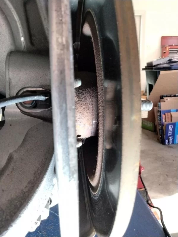

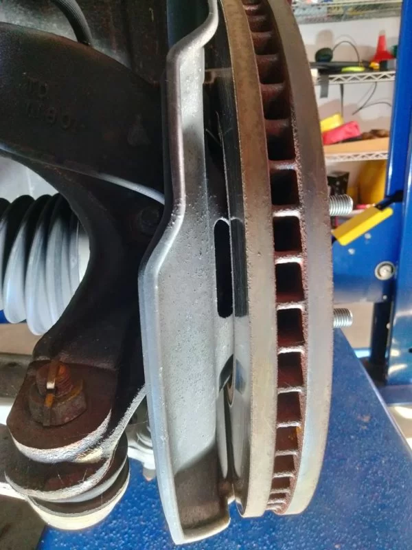

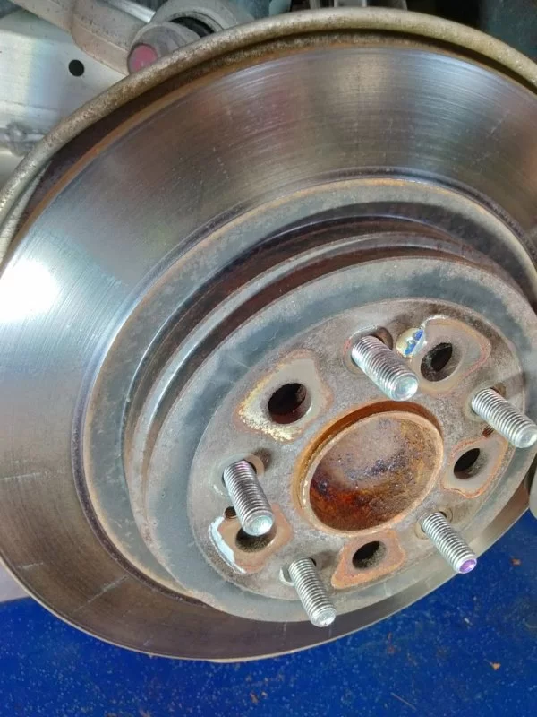

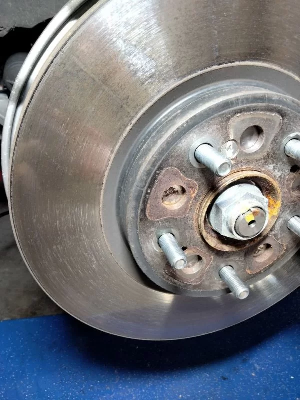

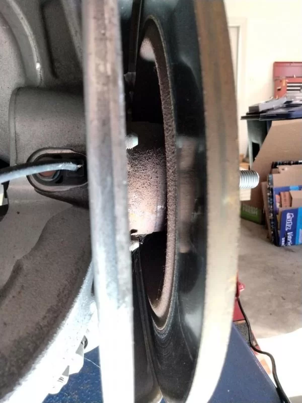

Here are some photos of my original rotors (outside & inside of a front rotor, and outside & inside of a back rotor). The other two look just like these...
This is a 2018 with 44K miles (garage kept in Maryland). The rotors are practically as good as new with no signs of structural rust.

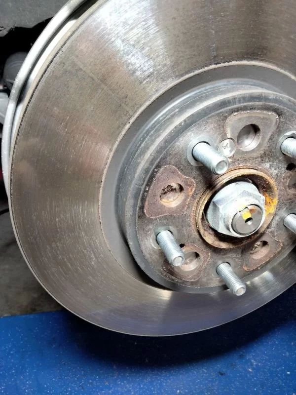

Similar to MrFixit, the surfaces of my brake rotors (inside/outside, for front and rear) look practically new. This is a 2018 with 53K miles and never parked inside a garage. I'm located in northern California, so road salt isn't a factor for me. The brake pads also look virtually new.
