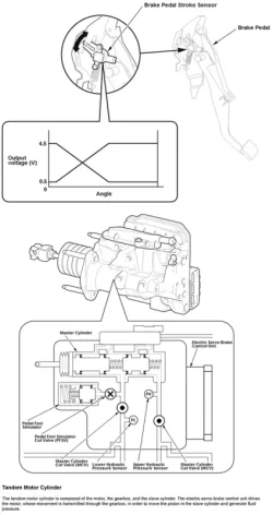

Bleeding the caliper on a Clarity PI is definitely unique. I had my wife pump and hold the brake pedal while I cracked the bleeder. What is odd is I only got one good pulse of fluid no matter how many times I had my wife pump and hold.
As you can clearly see from this Honda diagram, the master cylinder will emit a just a single pulse of brake fluid.
OK, I don't know what I'm talking about, but @Casey Martin, you obviously understand a lot more about braking systems than I do. There are more braking-system diagrams in this Honda Service Express PDF file, but nothing about bleeding the brakes.
I appreciate the information. That makes sense now. I don't know if the way I bleed the new caliper was correct or not but it appears to be working properly. I did visually see the piston in the caliper compress the brake pads onto the rotor when my wife was pumping the brakes. After I install the right caliper I will use the brake fluid flush machine at the dealership I work at to fully bleed them properly. I installed the caliper in my driveway not at work.
