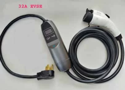

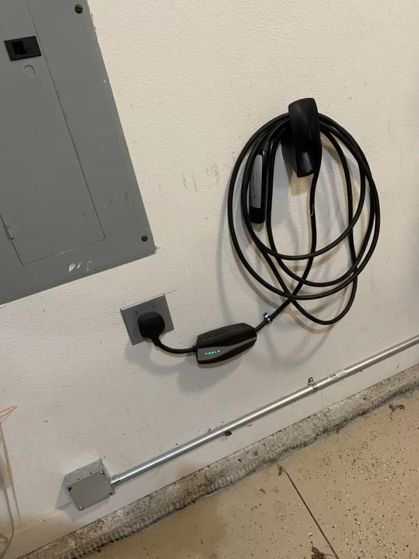

We use existing 220 in garage with 32A EVSE (see photo). Honda Link App allows scheduling charging time. We set for 1AM--cheapest power.

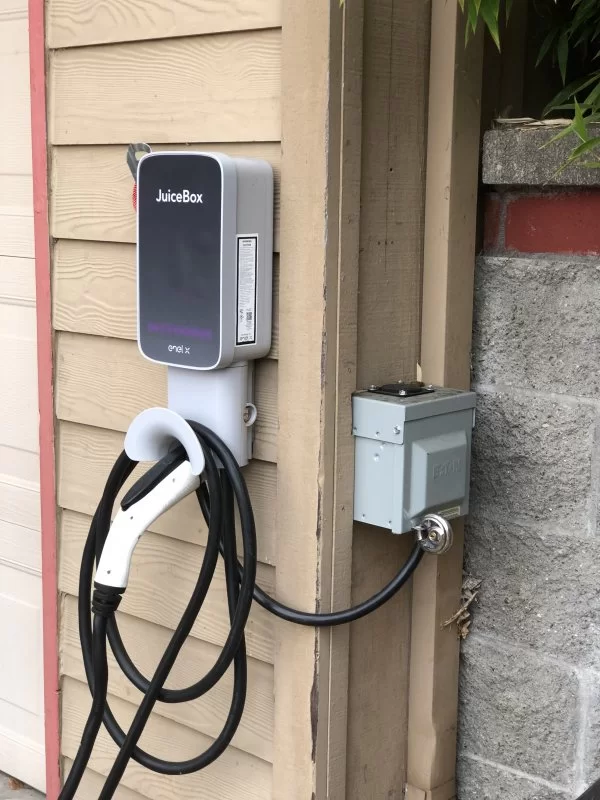

I had a NEMA 14-50 plug installed. While the plug is the failure point, it can be replaced. It also is a resale feature if someone has a different brand car. I bought a second mobile charger and did a “permanent” install as it was the cheapest solution overall. No plugging and unplugging and not locking into one charger either.
