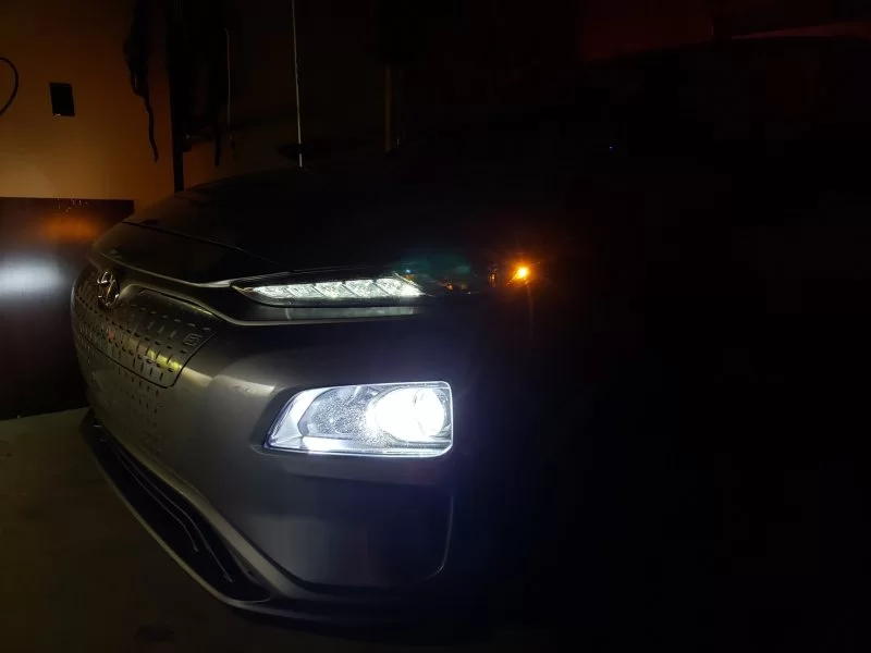

Tried to snap a picture. I think in real life it's closer then the picture shows. Hope this helps.
Not to be a contrarian but my impression is that the DRLs are more in the 5K range but ultimately its not a huge difference.
You might be right. I cannot confirm that as I did not get the 5ks. But if you do let me know. At night I don't see much of a difference, I am very happy with the clean white look. I would love to see some 5k lights. Thanks.
My HID bulbs are 5K, again they seem pretty much spot on to the LED DRLs
