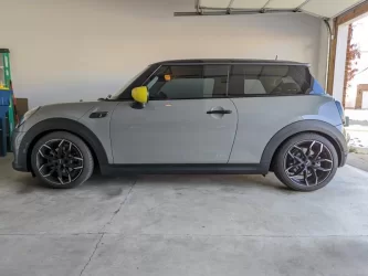

Before:

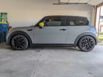

After:

I would have thought the H&R springs would have lowered the car more than that. The pictures from H&R show it lower but this looks great!

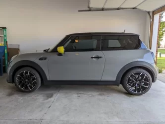

To be fair the photo is after only a short 15 mile test drive. The front looks to have settled maybe an additional .25". I'll grab an updated photo when I get a chance for comparison. And maybe some other views too if I can convince myself to get out in the freezing cold :/
