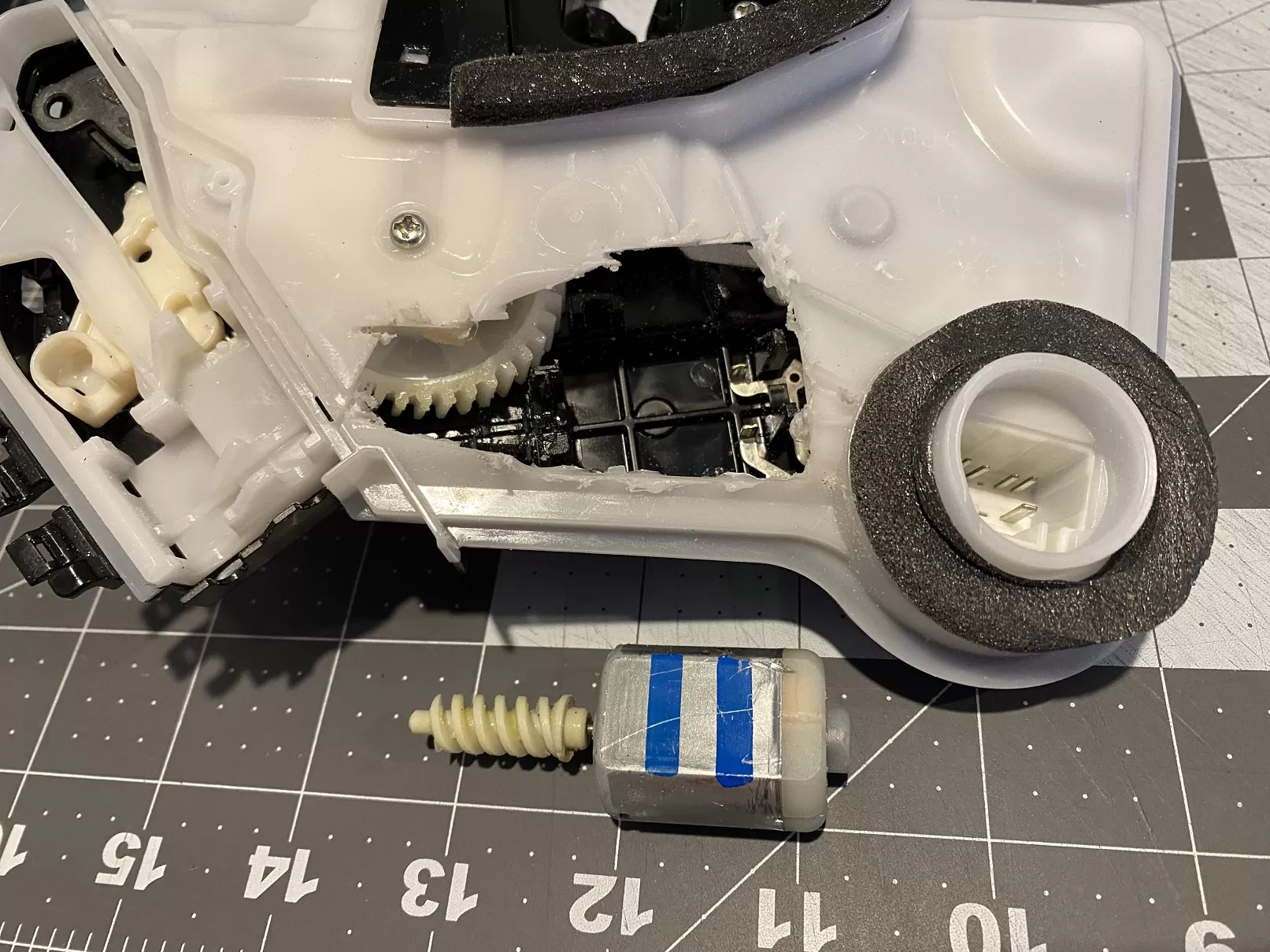

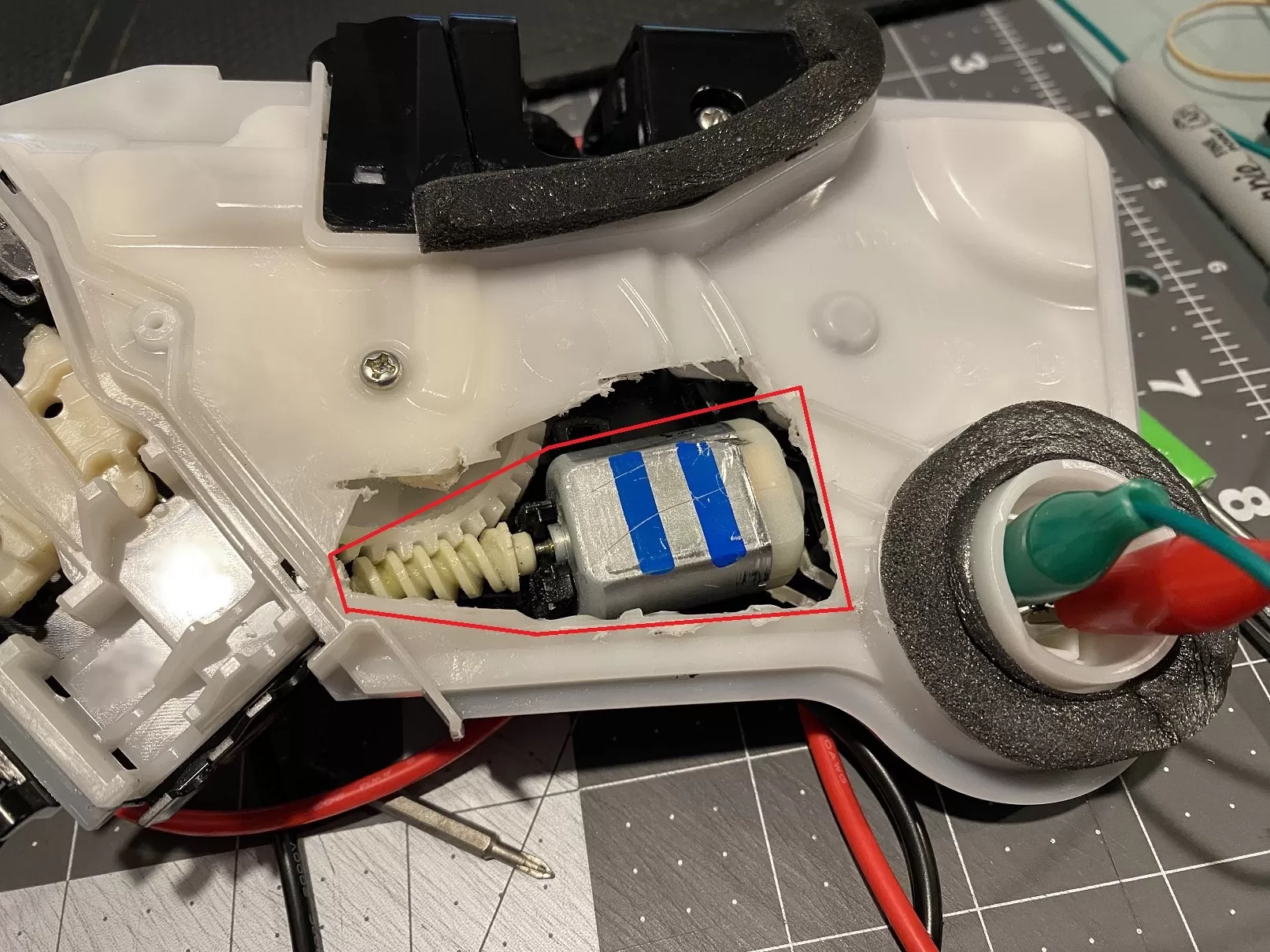

This is my old driver side actuator 72150-TRT-A02
The two halves, black and white are glued together, so there is no taking this bad boy apart without cutting or prying at it and hoping the glue gives before the plastic. So the optimal approach is to cut open the plastic to get to the motor.
The motor sits at around here:
I took a dremmel and slowly cut out a square, as you cut you can see that there is nothing where you are cutting, but you have to be careful not to cut too deep because you can hit the gears inside or the motor. Overall not very hard. Try to cut out as one piece so that you can glue it back on later with some Plastic JB Weld Epoxy (dont use superglue its too brittle and doesnt work on ASB well).
Also, do not cut the black part, you have to enter from the white side because all of the mounts and contacts are on the black side and if you cut through black side the motor will not have mounts to sit in.
I would suggest cutting less on the top, try to stay as I drew the red lines, this is because part of the gear mechanism relies on hitting some of this shell. What I cut above is fine however.

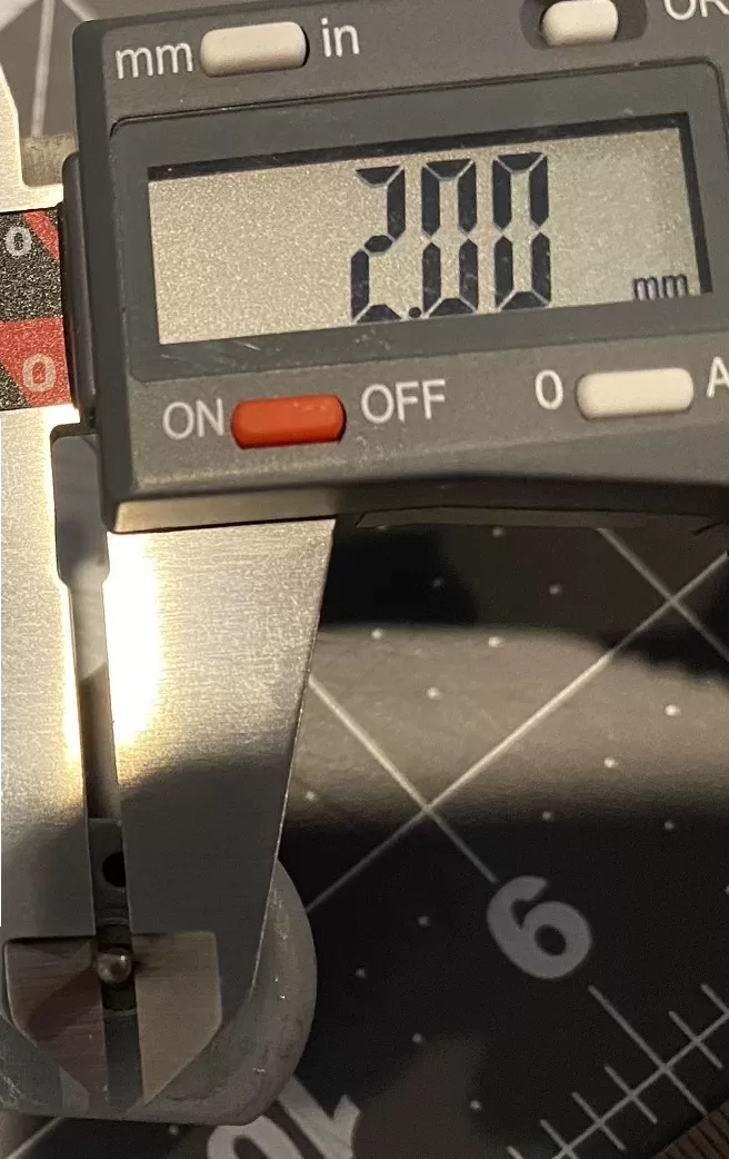

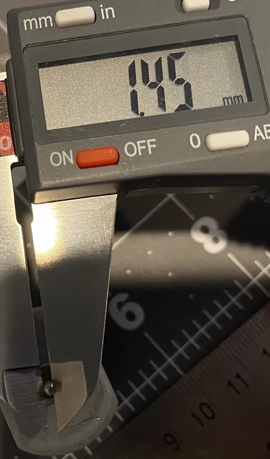

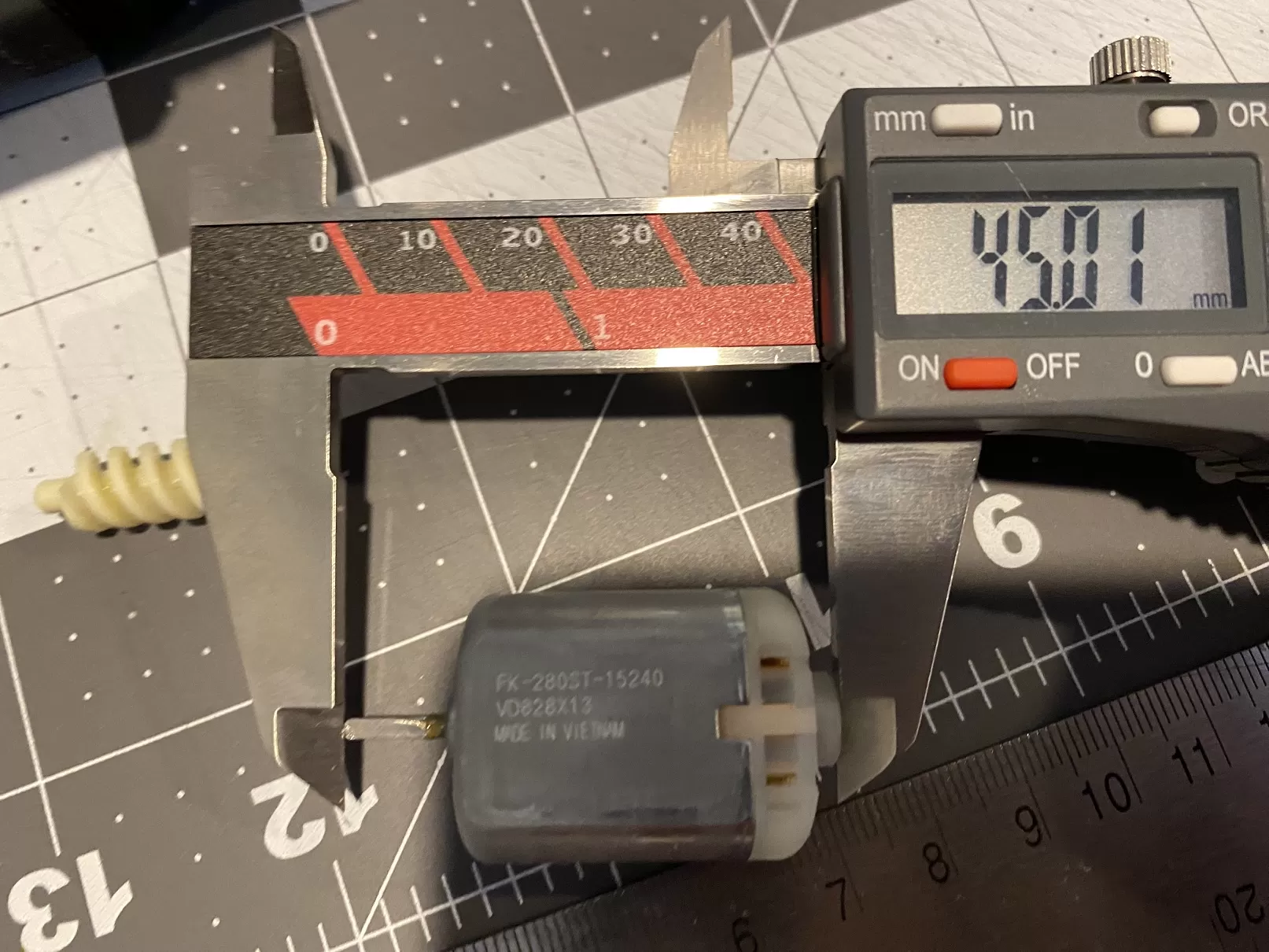

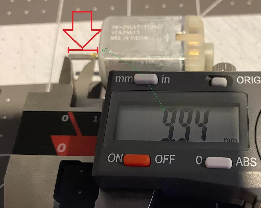

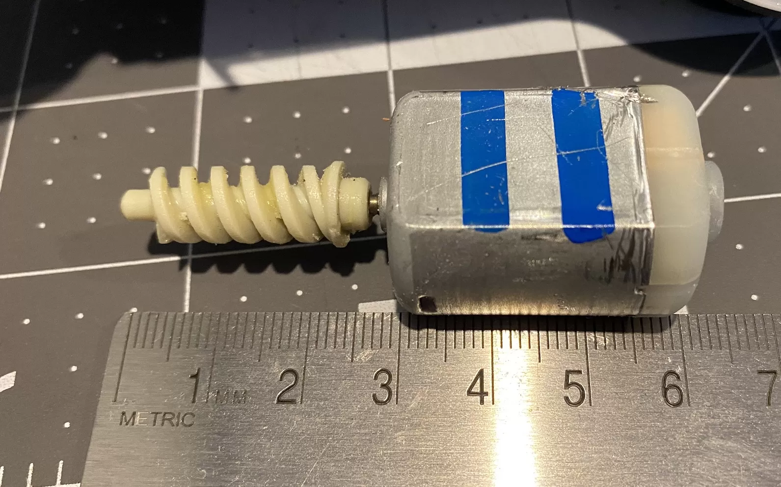

Motor dimensions:
Worm gear = 27mm
Motor body = 30mm
Motor + shaft (no worm gear) = 45mm
Shaft = 10mm
Shaft round width = 2mm
Shaft flat width = 1.5mm

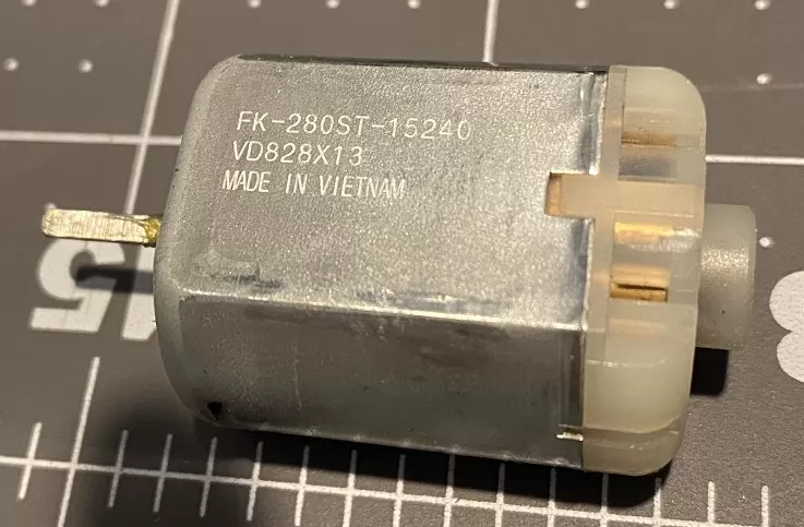

This motor part number is sold in bulk to car manufacturers, its not sold as one offs to anyone, so any units you will find for sale are likely salvaged (not new). There may be drop in replacements with different part numbers but I cant vouch for any since I haven't tried any of them.

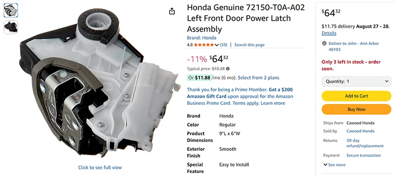

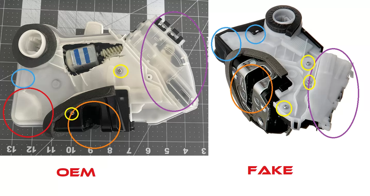

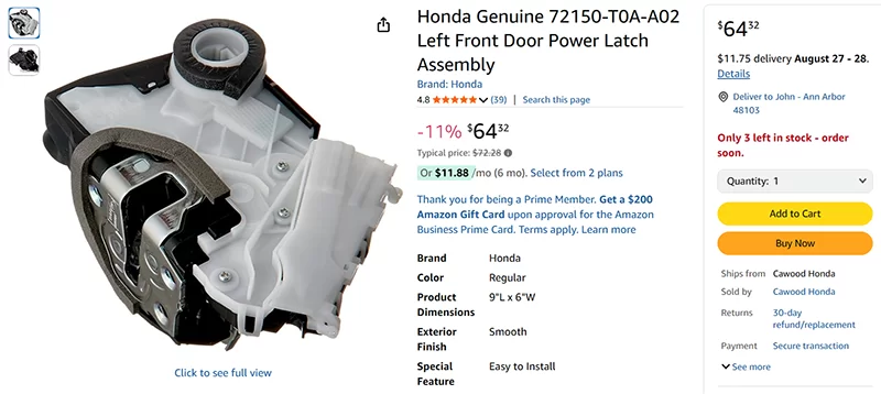

@Duxa, I love reading posts like yours! I don't work on my cars anymore, but it's great to read detailed procedures from those who do.
I didn't even know what a door actuator is, so I googled the part number you listed and found this power latch on Amazon for less than $65.
Edit

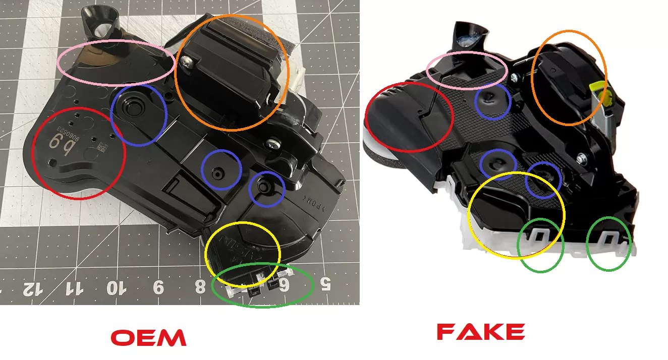

That is not the correct one (at least picture is not correct). It doesnt look like the one from Clarity.
Will it work? Maybe... Will it fit? Maybe... it looks to be a 3rd party non genuine part, or a part from a completely different car that wont fit. The opaque white plastic (cheap) is a giveaway. Also this one is held together via clips (cheap easy to make), while genuine OEM one is glued togehter, no clips.
No serial/model numbers being anywhere on it screams to me that this is 100% sweatshop fake part.
Here compare these:

The motors I got have the exact same markings (FK-280ST-15240) but have 2 green lines instead of blue lines, I tested them before putting them in to make sure the polarity matches, and it does (otherwise your unlock will become lock and lock will become unlock). So the green lines (instead of Honda's blue) either are a date code, or a supplier code (were originally supplied to someone else, not Honda). One thing to keep in mind, these motors are made as part of a supply chain, you will never find brand new ones, they dont exist in stores (not with matching model). But all 4 that I bought off ebay seem to be in like new condition. They work. Perhaps fell off a truck or salvaged off a new-ish car or part.
