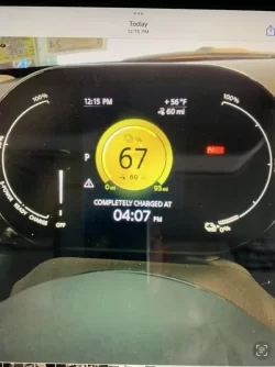

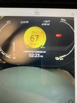

When I plug in my car to charge, the first time I plug in the Grizzl-E light turns green, and the car shows the yellow charging circle on the dashboard which has the percent charged visible, but nothing happens; the yellow circle isn't animating, and the app doesn't say the car has begun charging, and the light at the charge connector is light blue/white colored.
But if I unplug the cable, then plug it in again a second later, everything works instantly. The charge connector light starts pulsing yellow, the dashboard shows the animation, and the app immediately tells me when the car will be at 100%.

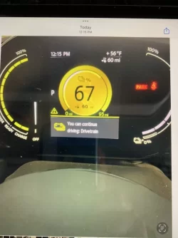

Looks like I have the same problem first plug charging in 50% slower time second plug in 15 second 100% up to factory specification .I’m using Cripper Creek charger 32 amps. 240 volts. Public chargers no issue.My dealer working on it he have no idea when
he check a car saying nothing
wrong with a car. He is contacting BMW headquarters looking for answers .Wander what will be an answer?
I know what is wrong but they not listen maybe my dealer learn in few month bc so far he saw only my SE as first EV in his facility .In my car is faulty high voltage contactor or mechanical relay which job is to safely connect and disconnect battery when I plug a car to charger .They can fix only ICE EV is to much for this facility.

Rexsio - that is interesting, and I wish you well getting that resolved. That's not what's happening to my car at all. Once the charge starts, everything works normally. I get no errors, the charge goes to 100% and my car operates normally. It just takes 2 connections of the plug to get it to start; nothing else.
I've contacted United Chargers, the makers of the Grizzl-E to see what they have to say.
That’s what I do 2 connections of a plug to get it to start and charging is correct to 100% and time is correct but only 1 plug in take twice longer to charge and I don’t like bc it shouldn’t be that way car have only 900 miles should work as design I don’t flip my lights switches twice to have a light in my rooms .
