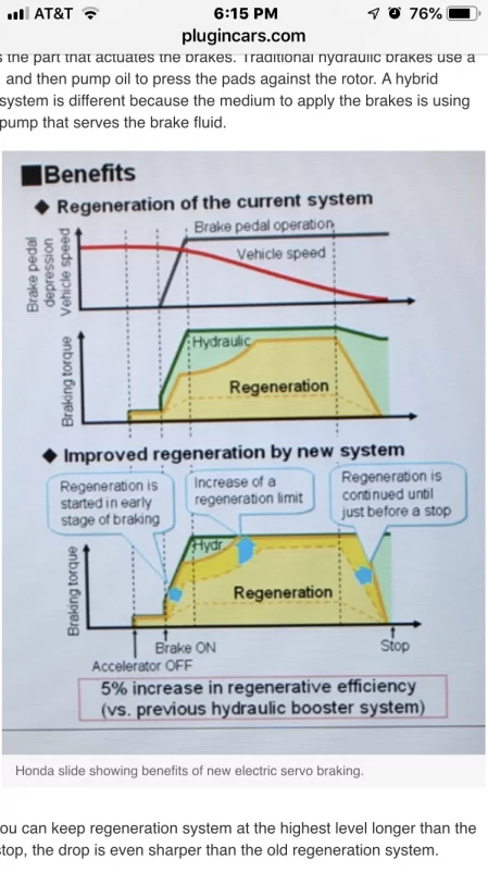

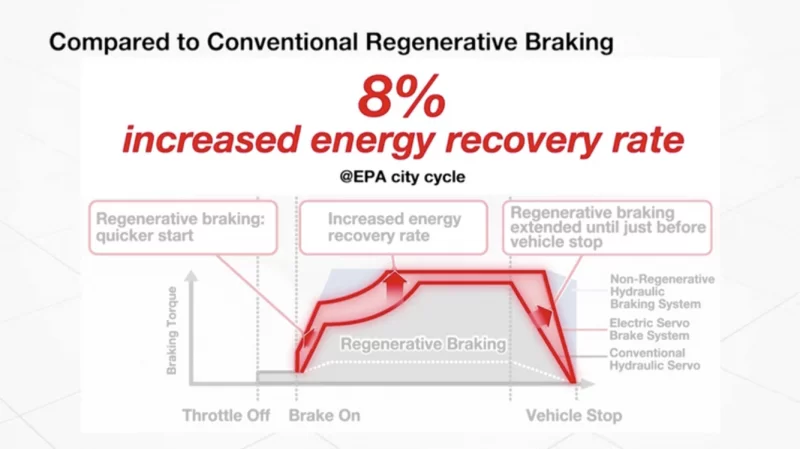

Here are two diagrams that show how Honda engineered it to eke out as much regen over stopping distance as possible.

Hey KKen, these are very interesting diagrams. Have you an URL for the source?
I copied then off this forum. I think @insightman or @Atkinson or someone I’ve forgotten might have the source.
As a way of apologizing for not being able to find the source documents, here is a very interesting paper on the development of the Clarity that has an amazing number of charts. Hopefully this will tide you over until someone chimes in with the sources for them.
I did find one of the documents but not the URL. It’s attached. I’m sorry but I can’t find the other one.

Thanks KKen for the information. Sometimes my friction brakes are a little noisy so I can tell exactly when they engage. I noticed that I don't hear them until at the very end so I had assumed that it's all regen until then. I'm glad this confirmed my own observations. There's been a lot of discussion where folks say they use the paddles to avoid engaging the friction brakes. This shows that there's no need to do that if that's the goal, just use the foot brakes normally. Honda's design not only results in more natural braking and more regen but it also dramatically reduces brake wear. It's win-win-win!

Thanks for the tip. I searched @Ray B’s posts and found the URL to the regen article I posted above.
So props to @Ray B for posting so many great source docs and @ken wells here is one of the URLs you requested.
https://www.plugincars.com/honda-reinvents-regenerative-braking-fit-ev-110596.html
