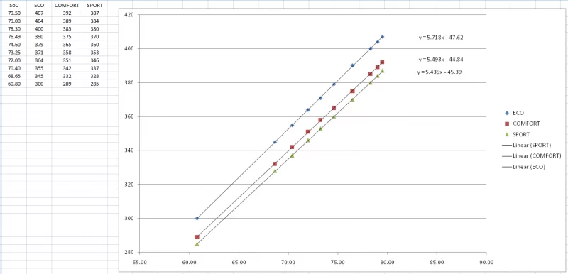

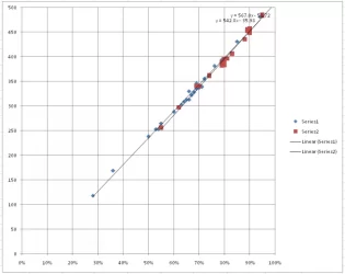

What I mean by this is that at zero GoM there is still some SoC, just like having a reserve in your petrol tank. The following graph shows indicated GoM recorded over one week of local driving on a single charge which shows that it is already remarkably linear within 60-80% SoC and has an extrapolated offset at zero GoM of around 8% assuming the relationship continues to remains linear under 60%. All I want is the option to manually set that slope and offset.

Yes but you’re still asking for a zero state from an arbitrary position based on SOC and recent performance. What you’re essentially asking is the GOM Show a range like the bolt does or always shows worst case scenario so the number is an over estimate rather than an attempt at an exact guess.. GOM By it’s very definition is largely a guess of your range; just like an ICE GOM is.

I'm not sure you can make that easy assumption. I'm guessing your drives that went into your calculation were kind of the same? Ex to work and back? This is a very specific case. Also, since your points of measurements stop at about 30 % SOC how do you know how it's behaving below that level. I'm pretty sure that graph changes, especially when turtle mode comes on.
The gom tries to work for everybody. And especially for everybody without the will to calculate graphs and adjust values. And I think it's pretty good at that.
I assume you're a very geeky person. I understand you want to have full control, I'm the same type of person, however, put yourself into an Automakers position. The liability that comes with a system that everybody can tinker with would be terrible. People getting stranded and blaming Hyundai for it because they don't understand the implications of their actions.
