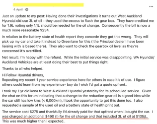

I had the gearbox oil changed at the last service at 45000km & got a sample of it. The oil cost $145/litre & about the same in labour. After using a magnet on the sample I can confirm a small amount of metal but such a small amount you could leave it. Hyundai said this was the first time they had ever done this.

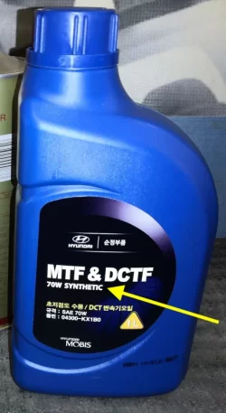

I would not recommend using whatever oil from Hyundai as they are probably not synthetic. Back in my 20s, when I was hot-rodding my Celica, Red Line and Amsoil are the 2 brands we trusted the most. Mobile 1 are consumer grade.

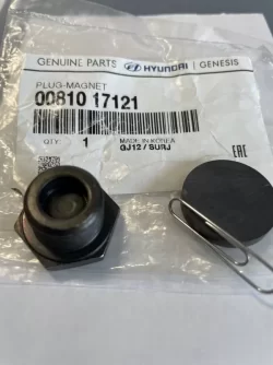

Need more info. Crush washers? Picture would be nice. As the saga goes on, I checked the "Plug-Magnets" I received. Guess what, they are NOT magnetic! Will not pick up a paper clip! :mad: I have shown this missing magnetic action to my dealer they said - hmmm. Return them. The problem is that I bought these at an other dealer. I will take them back to there. But returning them will not solve the issue does it?
The experiment - How magnetic is this?
Hyundai part, real magnet and a paper clip
