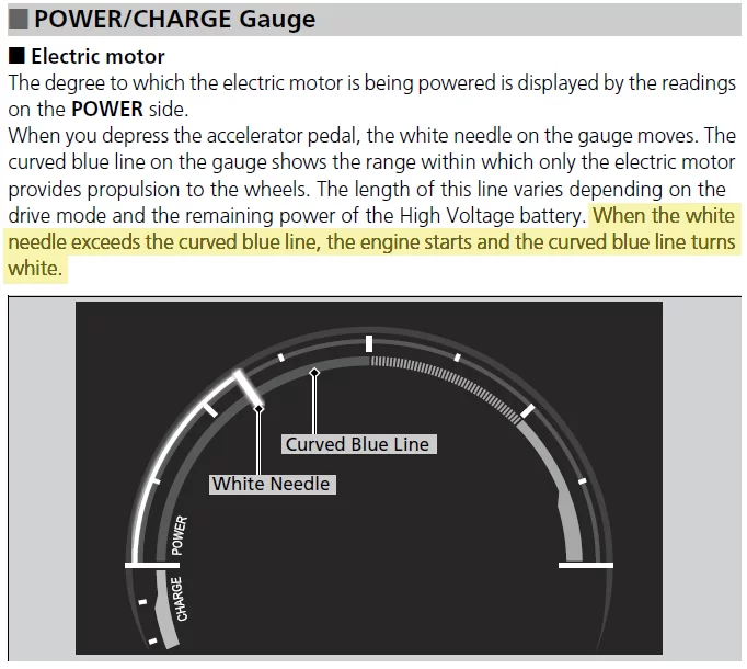

For the benefit of others who may come across this, it’s pretty normal behavior for the Clarity to do this, not an indicator of a problem.
When the battery is full and you're going on a decline. The engine will kick in because the car can't Regen anymore electricity into the battery.
What you noticed the second time (bar going white and car going in and out of EV mode for 15-20 minutes) is likely a "system check" that the car does every few weeks. It is a bit opportunistic; if it's been a couple weeks since the last one and the engine comes on for other reasons (e.g. flooring it or regenerating with full battery), it'll do the system check then. After ~3 weeks if the engine hasn't run at all it can just happen even without a trigger.
