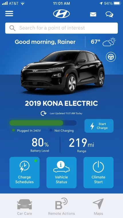

In April the Campaign P29 was performed on my vehicle, verifying my max charging limit to be 80%. The mileage was ~220 miles, when charging to 80% (consistent with a 100% mileage of ~ 275 miles):

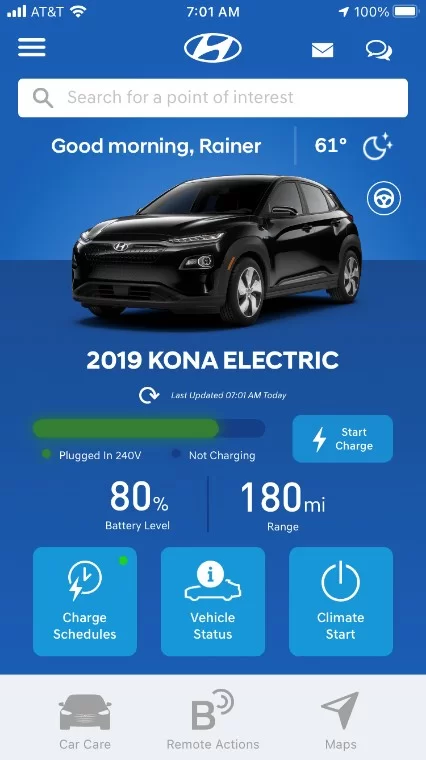

After another visit to the Hyundai service department for a 12V battery discharging problem a couple of weeks ago, I noticed that the 80% charge level corresponds now only to a mileage of ~180 miles:
I suspect that an update had been performed, which redefines the prior 80% level (with ~220 miles) as a ‘new’ 100%. As I have my charge limit still at 80% the resulting range is only 80% of 220 miles: ~ 180 miles.

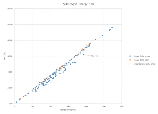

Update to my original post:
I collected data for several home charging sessions (240V home charger):
For each charging session I noted the SOC % at the start and the SOC % at the stop and the time it took for that charge. If I plot the SOC charge % versus the charge time and compare prior charging sessions (blue dots) and the ‘new’ charging sessions (orange dots) it becomes clear, that nothing has changed:
Conclusion:
My initial suspicion, that the prior 80% SOC level had been redefined as a ‘new’ 100% SOC level was wrong.

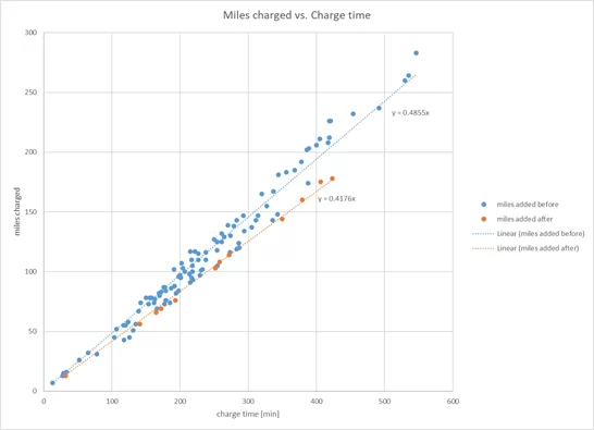

It is simply, that the available mileage displayed after charging had been reduced:
Still, I don’t know, why that would be, as I have not changed my driving style and the average ~ 4.1miles per kWh as displayed on the Drive Info is still the same.
