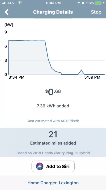

I just Level 2 charged upon arriving home and my ChargePoint EVSE added 7.30 kW and Honda Link reported 99%. So I used HL to start charging again and CP reported it only added 0.06 kW. And HL now reports 100%.
The math says 0.06/17 kW is just 1/3 of 1% more charge. So I’m not considering it an issue if HL reports 99 instead of 100% at times since in this case it rounded 99.7 down to 99%. Not gonna quibble over 0.3% SOC and 0.06 extra kW.
