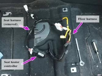

Well, today I finally took my shiny new E12 in hand and tackled shotgun-seat removal. Easy-peasey, for
the most part. The little pop-in clips that hold the harnesses agains various brackets are fussy to pop
out without breaking the ears, but that's minor. I cut most of the ears off anyways and added velcro
cable ties, as I now consider this a modifiable setup.
All we need to restore the functionality I'll need in winter is the seat-warmer controller, which does both
front seats. With none of this plugged back in, the car booted absolutely without a whimper -- no warnings,
not even about an airbag disconnected. Doesn't care. Plug the harnesses back together, and the seat
heaters work again. So this can just lay there under whatever becomes the updated bed platform or
storage solution. The existing mini-platform still fits in fine, it had no dependence on the front seat.
And the roadtrip storage space opened up is *cavernous* by comparison. I just wish the 60/40 rear
seat split was the other way round.
