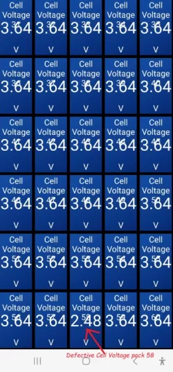

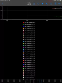

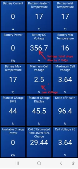

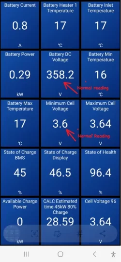

Well, after reading all the posts and having the same issue and having the dealer find nothing each time I presented the issue, I decided to investigate the issue my self and do some data collection via the ODB scanner and the car scanner software for android. I created several pages to monitor the battery packs and waitied for the problem to show up. Low and behold I finally tracked it down to a single battery pack #58 ( in my case). As it turns out, I saw the volatge suddenly drip 1.5 volts multiple times in a few seconds and that instantly triggers the "power limited" I was fast enough to take a screen snapshot of the pages. Here they are, now KIA has no choice to accept there is a battery pack issue and/or BMS. I will report my findings to the dealership when I get back to my home city and keep everyone posted. Cheers
Nice work - however, it is completely ridiculous that you had to do this investigative work. 99% of the population would not have the wherewithal to do this and would be stuck managing the problem until something more catastrophic occurred. Ridiculous.
My next EV will likely be a Nissa Ariya, VW id.4 or a Kia EV6. The Ariya is virtually unavailable except for some really expensive high end trims that I don't want to pay for. The id.4 is a maybe. Not nearly as sexy as the Ariya or EV6 and they've had their software issues in the past. The EV6 has been under consideration but with problems people seem to be having with both the vehicles and the dealers has me wondering. The main draw for the Ariya is that my Leaf has been rock solid dependable. I'm waiting for selection to improve before making any decisions.
The car should trigger a dash light on a cell balance difference of 0.1 V or greater but perhaps it's not sustained long enough to catch.
"2.5V" sounds almost like a bad connection to the BMS as that's a lot for a cell (or 3 in parallel if it's a 2018-2022 model) to change, plus that might be the minimum readable value for that parameter. If it were a loose connection in the power bus there would be a lot more drama.
Since Hyundai/Kia (and everyone else unfortunately) haven't reached the point where packs can be repaired by dealers, it will mean a new pack.
Thanks, but the dealers are all clueless, it's amazing how little they know about troubleshooting the car, and even with all this data, they are still sceptical. Unbelieveable. So disappointed. Last Kia electric for me. :-(
