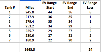

My question is "Why the battery loss?"
He stopped to fill up the tank 7 times, shutting the car off. And presumably stopped a few more times than that also for meals or bathroom or whatever. In my experience the car loses a couple miles of EV range every single time you activate HV mode, before it finds a new "level" point and maintains that level of charge. And you do have to reactivate HV mode every single time you shut the car off and turn it back on, because it always defaults to EV mode with a restart.
So his gradual drop in EV range over a trip of that length does not surprise me one bit. Not necessarily because it's right, but simply because it is what my Clarity does on similar extended road trips as well.
I concur with @craze1cars. My experience from Mi to Tn all in HV mode: virtually everytime I restarted the car I would use a few electrons. When you think about it, if you go 2-3 hours between a rest stop, or gas fill up, or a meal you always have a new set point for your EV SOC. If you lose even just one mile of EV range per startup you may lose 5 miles of EV range per day. On my trip to Tn and back I lost about 12 miles of EV range while in HV the whole way.

So have I. As I've mentioned here or elsewhere, on 100 mile trips across the mountains I've gone to HV with 20 EV miles remaining, and in spite of excursions down to maybe 16 EV miles remaining on long uphill grades, it almost always drags itself back up to the "set" value eventually.
But this was a 1,600+ mile trip, and it did not hold. Here's the details:
As an aside, I would love a way to set on the display the mileage you want to maintain, and have the car do a better job of maintaining that level, even if it had to dip into "HV CHARGE" mode to do so.
