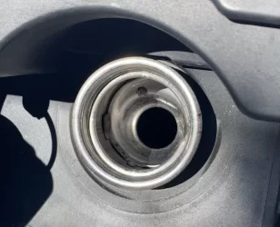

Here’s a photo inside the fuel door. I don’t look in there often and never noticed, until today, the enormous size of the opening before the actual hole for the gas nozzle, which is an inch or so down the big opening. The passenger vehicle size diesel nozzle would fit and the truck stop size nozzle may fit as well. But there’d have to be a load of diesel spraying all over the place during the effort. 689E923F-5A64-4771-AB68-446C536350DA.webp
This isn't a Clarity specific thing. The outer size is a standard size shared by most screw in caps (there are other caps that are quarter turn, and some where the flap is the cap). Almost all cars have that "weakness".
The smaller inner diameter dates from the early days of unleaded and was intended to stop people from putting leaded gas into cars with catalytic converters. That it prevents diesel was an unintended benefit.

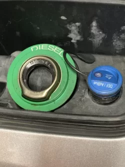

For reference, here’s a clearly labeled passenger vehicle size diesel fuel port that uses no fuel cap, next to a DEF fill port, which is also clearly labeled. Of course a gas nozzle will fit in the diesel port, which would really make a diesel sing. 5F460FA3-A2C5-48A3-B531-9B95856242D2.webp
