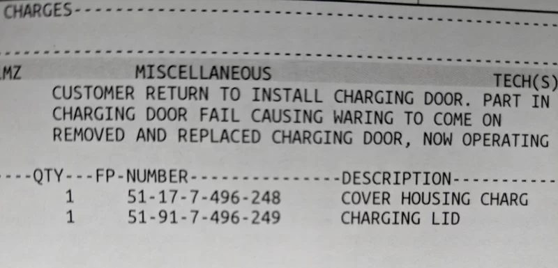

Interesting that it mentions removing and replacing the "charging door" - I'm going to assume they didn't actually replace the door/flap, right? Since the part going bad is the plunger which isn't in the door.
Looks like the part numbers include the exterior flap (called the lid). But matching the body paint adds a wrinkle.
There's a black plastic part that holds the color matched flap. That's what they replaced along w the magnetic push latch (don't know what it's called).
51-91-7-496-249 is the color-matched flap, so your paperwork says they replaced that as well.
