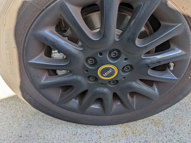

Yesterday, I noticed that my rear passenger wheel had brake dust all over the rim, not on any other wheel.
I only use my brakes to hold after the high regen brings me to a complete stop.
I assume this is from traction control, but I've never seen this before. I think I might need to turn traction control off, if it continues to happen.
Anyone have any other insight?

Option 1:
Because it's only on one wheel, most likely the parking brake was dragging a bit. If you roll down the windows and drive slow you should be able to hear if it's still dragging.
Option 2:
Because it's the rear wheel, it wouldn't be traction control but could be stability control. Were you having a bit too much fun down a curvy road?
Not sure why this would be only one wheel though, unless you did a dozen laps on a roundabout lol. Maybe it happened to get wet or something so the dust stuck better?
Option 3:
If you charged to 100% (or were driving very aggressively and the drivetrain was too hot), the car will use the friction brakes to slow you down even if you don't touch the brake pedal. Again, not sure why just one wheel other than possibly getting wet
Just checked again, and it looks like there's brake dust on the other rear wheel. Not sure why I didn't see it yesterday. I think you're right about #3: I was fully charged so probably was using the friction brakes.
Thanks!

Brake dust is also brown-ish not black (see first post's picture) so it's some other mysterious substance coating your car
