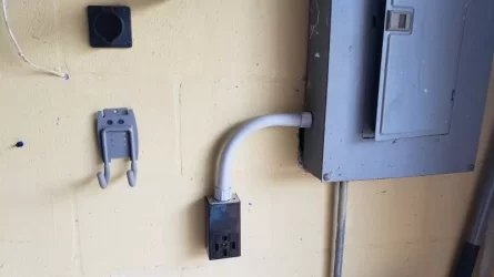

I sent them another e-mail if they can exchange it for the 32 amp version with the 14-50 plug as it is a "safer" plug due to the ground wire.. The 32 amp version of the EVSE is actually cheaper on Amazon than the 26 amp NEMA 10-30 version.
Changing the outlet to 14-50 is fairly simple.. probably $20 in materials and 30 mins of work.. I believe that #8 wire is still fine for the 32 amp EVSE.. However, I believe that by code I'm required to go with a 50 amp breaker on a NEMA 14-50 outlet even though 40 amp would be sufficient for the 32 AMP continuous load.

I'll change my outlet to 14-50 tonight. May also rewire with #6 or #4 wire instead of #8, just to be safe..
Sounds good. I would go with a 40 amp breaker (OK with #8) for safety. And changing to #4 wouldn't be easy as it is quite a job to install (does not bend easily).

#4 is a pain but #6 isn't much different than #8.. I'll probably leave #8 wire for now as I have no intention of exceeding 32 amps but I may upgrade in the near future as I could use the outlet for my welder too. Currently, I'm using my welder on 120 volt and it doesn't have a lot of power... I can change it to 240 Volt when I need to weld thicker materials.. I don't really weld too much but I do have damage to my riding mower's deck and I need to weld it and with 120 Volt, it doesn't work too well..

I could be wrong, but doesn't the use of a 32A EVSE require a 40A breaker (instead of 50)? I also have a welder but have it wired on a separate 50A circuit. It uses a different outlet, 3 wire, no neutral.
I'm not sure. The NEMA 14-50 really is a 50 amp outlet and I'd think that a 14-50 outlet would have a 50 amp breaker. It's just like a regular 120 volt outlet.. You don't use a 5 amp breaker if your cell phone charger is only 3 amp maximum.. You'll still leave the 15 or 20 amp breaker. In my house, all 120 Volt outlets are actually on 20 amp breakers. I wonder if there is a different rule for EVSE's that you require a breaker specific to what you connect to the outlet. The danger I see is in case you sell the home and someone plugs in something with a higher load, it will trip the breaker. I'm not sure what the requirements for that are.

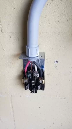

For now, I'll leave the #8 wire and 40 amp breaker.. All I need to change is to wire the ground and run it through the conduit to the new 14-50 outlet.
The minimum building code places limits on circuit breaker current rating according to the conductor size being used and not based on the max capacity rating of end receptacle(at least as far as I appreciate). So yes theoretically #6 or 8 copper wire, especially short of a run as you have would be fine with a 50 amp breaker. That said when a circuit breaker is installed you should also give consideration and size that breaker so it will protect both the equipment (EVSE) in the circuit and wire. Unless you really think you will be using 50 amps you should probably size down to the 40 amp breaker.

So, I left the 40 amp breaker and ran the ground wire to the new NEMA 14-50 outlet. Had to increase the size of the conduit to 3/4 as I couldn't fit the ground wire through the 1/2 inch..

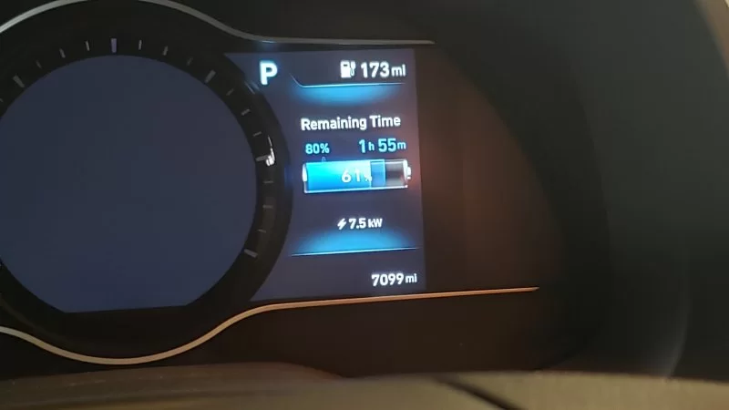

Got my replacement 32 Amp EVSE and tried it for a minute.. Dash shows 7.5 kw speed.. Awesome. Hopefully, this one won't heat up like the 26 amp version.
Got my replacement 32 Amp EVSE and tried it for a minute.. Dash shows 7.5 kw speed.. Awesome. Hopefully, this one won't heat up like the 26 amp version.View attachment 5980
That's excellent news, no more having to charge at local machines. Is it the same manufacture as before?
As you are aware it will take more than 1 minute to show signs of heat
