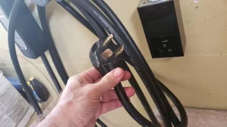

I am not a huge fan of those old type connectors and am surprised that the EVSE came with one (can you take a close up picture?) receptacle and male cord cap.
That's what I thought. Just check temp and monitor current, who knows if the male end is crimped ,soldered or screwed in. You can always change the cord cap and receptacle if needed ( to a 14-50 seeing as you fed w/ #8s and 2P 40 o/c device)

The wire gauge looks correct and is rated for 105 degrees C. The part I pay most attention to is the J1772 end as an overheat there would ruin the pins on the car.

The male cord cap gets the hottest as do the first 1.5 feet of the cable to the EVSE control unit. From the control unit to the plug that plugs into the car, it is only warm, not hot. If I would guess, I'd say that the cord cap is about 50 to 55 degrees Celsius
As above, suspect cord cap. Let me know how it goes . BTW those molded receptacles are not the best either , I would use a 4-11/16 box and a range receptacle c/w a 14-50 cord cap. (and maybe a 3/4 inch elbow to the panel) not 1/2

I don't think that mine is close to melting but it definitely hotter than I'd like it to be. I will keep looking for my laser temperature gauge to get more details on the temperature before contacting the manufacturer. It's not the outlet that is too hot.. it is the 10-30 plug. The outlet heats up but to a reasonable range that I would consider normal.

Outlet: 45 C
Plug: 55 - 56 C
Cable where it exits plug 73 - 74 C
Cable after 1st foot 45 C
At J1772 plug, 40 C
I'll defer to electriceddy's comments but I personally would replace both the plug and the socket at minimum. If the wiring to the panel is short, perhaps even change everything to a 4-wire type, or install a wall mounted, hard-wired EVSE.

Yes . I didn't suggest that, eliminate the connection and hard wire with split bolts (insulated) would be best.;)
The adjustable amperage portable type EVSE with a cord cap are great if travelling to an area such as campgrounds, but hardwired is better way to go for a permanent installation to avoid connection issues. The video positively confirms that the cord cap is creating the access heat. 73 degrees is too close.
