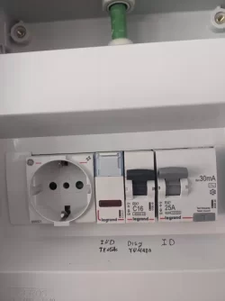

Btw, here's a picture of my previous setup with the 16 A regular socket (giving you an idea about the remaining components used on the circuit - btw, I've got another breaker on the main breaker board inside my appartment). I've only replaced the socket with a new one. The breakers are still the same.
