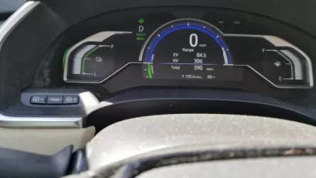

This was my EV range the other day after charging. I only wish I could get 84 miles. Yes, the range is based on earlier driving conditions The 84 was based on my going to the mountains using the battery up and then coasting down (recharging) making it home with just a bit of charge left.

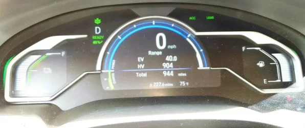

We are on a trip. Started out with 47 miles of EV Range. Drove EV for about 5 miles, then entered the freeway and switched to HV. I expected the car to bleed off battery power little by little until it has dropped to 58% charged. But that didn't happen. The car maintained the charge level at about 40 miles estimated while we drove at 75mph on the straight and level highway. After 227 miles it still shows 40 EV miles.
That's the behavior I've always seen although in hilly terrain the EV range may drop 3 or 4 miles and slowly build back up. I actually like that it works that way since I typically save the EV for city driving at the end of my trip.
