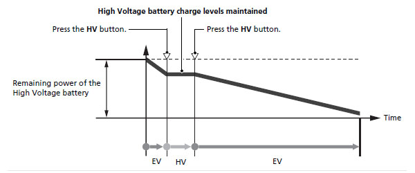

Remember - if you are in ECON and EV and press the pedal past the indent the ICE will always come on.
I did not know that. So.... how far you press the pedal determines if ICE needs to start?
I thought if I was in ECON and had battery power I am assured of using battery in EV regardless of the pedal position.
Many on this forum have been too timid to press their accelerator pedal hard enough to go beyond the "click" or detent point. You can check it out even when the car is off because it's purely mechanical. Unfortunately, it's not variable, so the click only has meaning in ECON Mode. The engine starts up before the click in NORMAL and SPORT Modes. Here's the graph from the Owners Manual that illustrates when the engine starts up in each mode relative to the click point in the accelerator travel.
